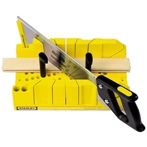

So I found two knives I love, but cant afford. The Fehrman Last Chance and the First strike. Both of them have the same handle which (maybe a stupid reason for liking a knife) but is why I like them. I was wondering could anyone here advise me how I could put that kind of crosshatch pattern on another knife, for example an Esee 6. I wouldnt want to ruin the knife though...
Preferably Id get almost identical handles and put them on an esee 6 or similar knife, so if anyone knows how to make those handles and wants to give me a quote that would be cool.

You can do it on a mill
Or you can do it with a file

Hacksaw blade sounds right.
I'd set up the scales in a mitre type box and saw
$20 to buy one, or make one with some wood scraps.

You need a mill to do the pattern illustrated because the lines are interrupted in a few places. You can get a simpler pattern with hacksaw or file.

no you could do it with a hacksaw and a round file. the areas where its "interrupted" are just filed down to make grooves just below the bottom of the line cut with a hacksaw
The truth is that what is known as a "nail saw" with a hack saw blade that has 32 teeth per inch or so,is what you want to start with and then go to a file and then sand paper wrapped over a thin rod. To see somr of my work where I have done this go to cutomknifegallery.com enter and scroll down to the Persian that is for sale. Frank
