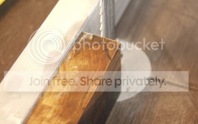

Here I am starting out with a block about 1&1/8" thick. I need to cut this block into 2 evenly matched pairs of scales. The block has flat faces and edges that are square to the faces. This way when the block is set with the edge flat against the table, the face is flat against the fence.

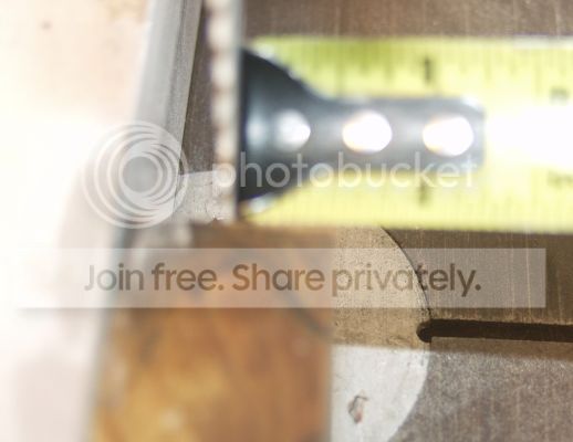

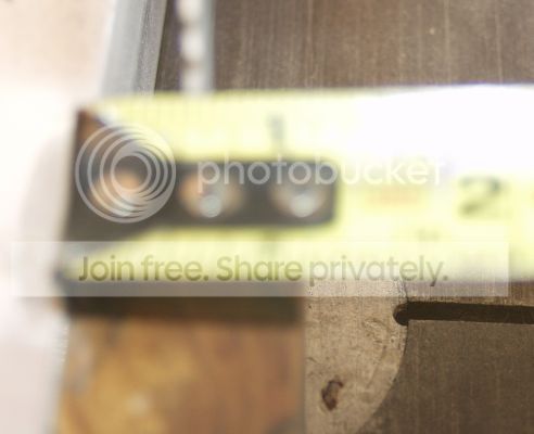

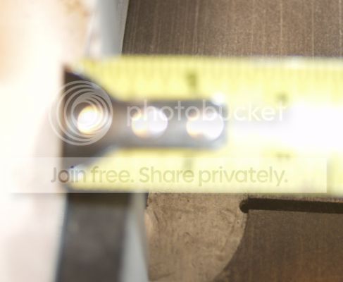

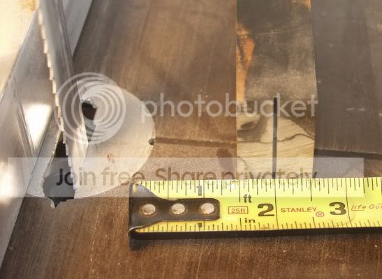

With the block flat against the fence I measure from the surface of the fence to the inside of the saw blade.

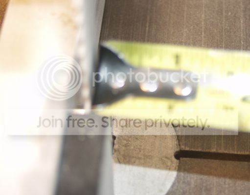

Next I measure from the outside of the saw blade to the outer edge of the block.
When I have made adjustments to the position of the fence so both of these measurements are the same, I make a very shallow cut to make sure I didn't mess up with my measurements.
This won't always be exact but you want to get as close to even as possible.

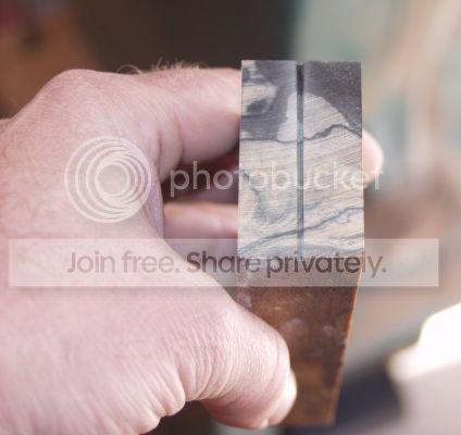

Now that I have double checked everything I am ready to make the first cut dividing the block into 2 even thickness pieces.

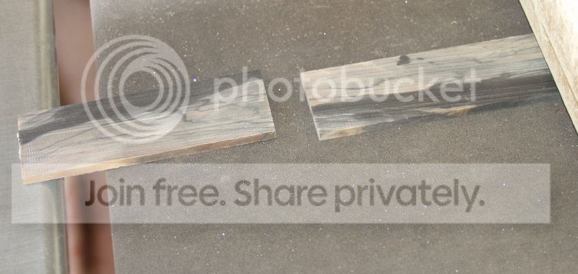

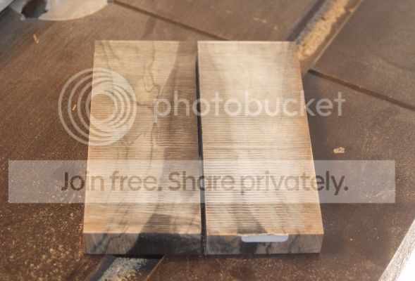

Here the 2 pieces are placed next to each other on the flat surface of the saw table. Feeling with my finger I check to see if one block has a higher surface than the other. I got lucky and both are really even with a barely noticeable (couldn't tell by measuring, but could by feel) difference in thickness.
I took the half that seemed just a fraction of a hair thinner and placed it against the fence. I repeat the procedures as before to cut into even thickness pieces.

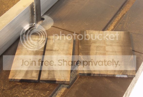

After cutting the two pieces into equal halves I have two sets of scales that have been cut equally. This finishes the part done with the band saw.

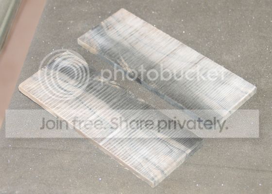

As you can see from the photos, the bandsaw cut leaves little ridges in the surface that will need to be sanded away. The blade can also wander a bit as you are cutting so the thickness of the pieces will need to be trued up with the drum sander.

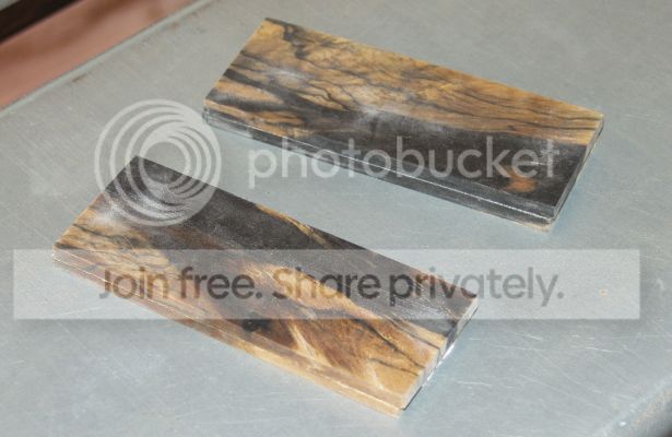

Here I have the 2 bookmatched sets separate from each other.

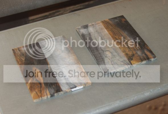

The first couple of passes through the drumsander are to true up the thickness of the scales. The scales are placed face down so the majority of material to be removed will come from the backsides.
You want to run one set at a time through the drumsander to keep from getting things mixed up. After a few passes the backsides are even.

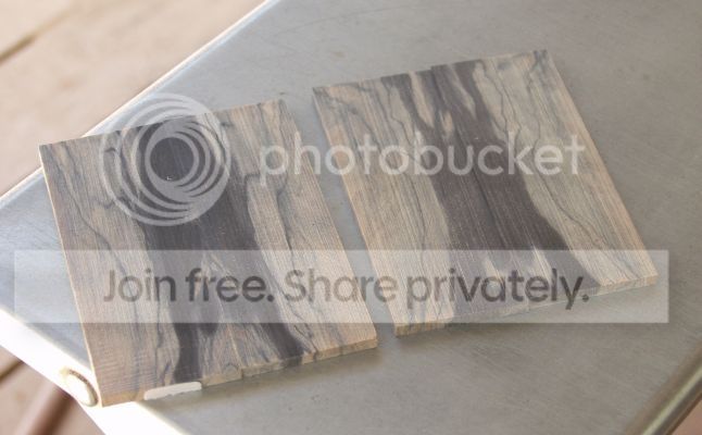

Now you flip the scales over to sand the faces.
All you are doing here is sanding away the saw marks. You want to remove as little material as possible so you will have a good match between the two pieces.

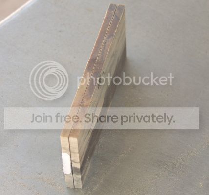

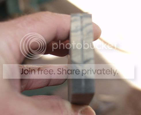

Standing a set that has been drumsanded on edge you can see that both pieces are flat and equal thickness.

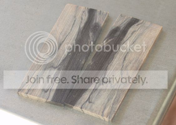

Here both sets are laid out showing the bookmatched surfaces (faces).

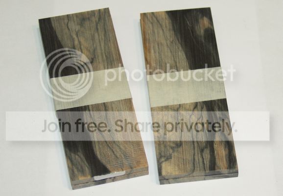

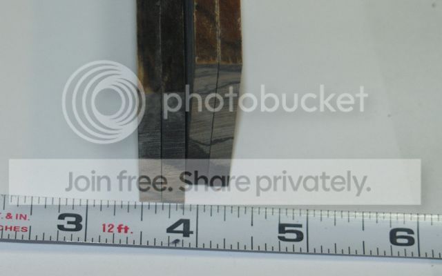

Next I just close each set like a book and wrap a piece of tape around them so I don't get things mixed up. These were pretty obvious which pieces matched each other and which surfaces are the faces but some pieces can be really close in appearance and easy to get turned around or mixed up.
In the end I have two matching sets of scales that are about 3/16" thick. This was starting out with a block that was about 1&1/8" thick. I got lucky with this set as there is usually just a hair more waste than happened with these.

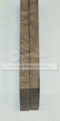

So, two other ways of doing it for those of us in metal shops that keeps blades far away from fingers and results in flat cuts:
Glue to a sacrificial board, and feed through a horizontal bandsaw
With a fine feed, this approach frequently results in surfaces that are straight and flat and smooth enough to require no additional work.
And squaring up rough sawn edges with a chisel ground fly cutter
or put it into a mill vice and slit it with a thin slitting wheel

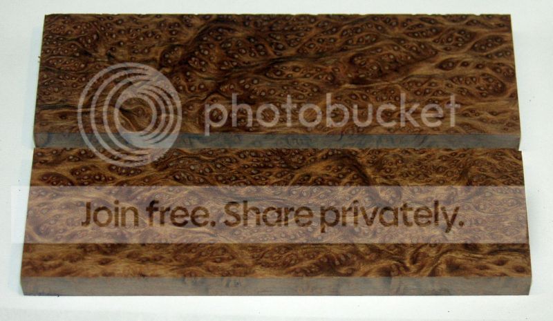

Again, the finished result is frequently ready to go as is. I use this approach when cutting up expensive wood because it is very accurate and takes a narrow kurf, so there is little waste. You'd be amazed how much more yield you can squeeze out of a stick of wood this way. I'm doing some of this today on some spendy buckeye burl.

What kind of wood which is? Mark's stuff looks like it might be ebony with sap wood (do I get a prize if I guessed right?). The stuff I posted was osage orange.
