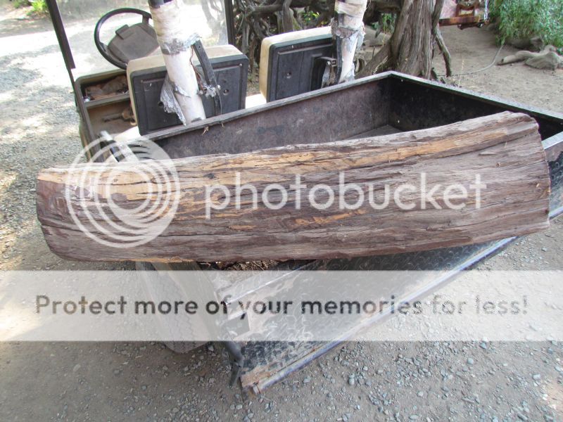

If they still want to try cutting the ironwood, this is how I explain to cut the wood.
There are other ways to do it but this is my way.
This is a 3 foot long log section that I have avoided cutting for the past year. Weighs about 80 pounds or so.
It was an old piece I got from a guy who had it in his workshop for the past 25 or 30 years. He was like me, hated cutting the stuff.
Looking at the cut end it is remarkably solid for Ironwood. Usually a lot more cracks.
1st thing I do is cut off a manageable chunk about a foot long.
Next I take that chunk and turn it lengthwise to cut a straight flat surface following the grain.

In the end you see there is about 1/3 usable wood and 2/3 waste. Bear in mind this log had a whole lot less cracks than normal for Ironwood.
This is what I have from the foot long log section. Will probably turn into about 8 or 10 blocks.
A couple things to bear in mind
Always use a new sharp blade.
Wear a mask because the dust is a nasty irritant. Even when just cutting.
