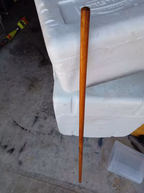

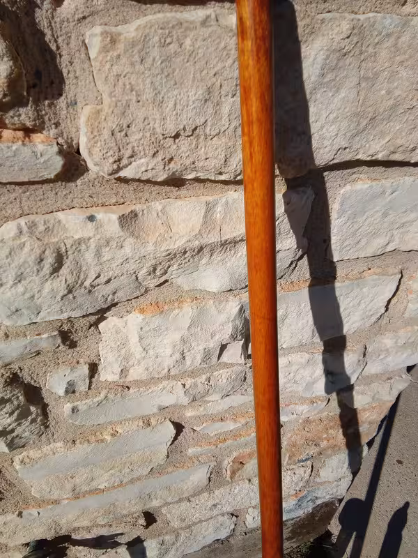

Here's my trash stick. What I use to spike the trash that blows into the yard. And I like using nice stuff for the lowest of tasks.
It began as a bright yellow. Light sanding and repeated coats of boiled linseed. It smells like an oil painting.

Very nice, that’s the color I’m going for. Maybe I just need to keep going with the boiled linseed oil
