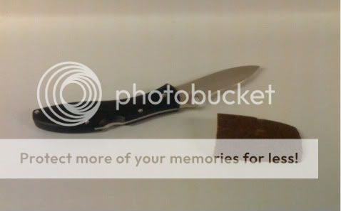

the other day someone commented that they wish there centofante 3's spydy hole was de-burred and polished , so last night at work i devised a simple cheap way to achieve this .
i used a 2.5"-3.0" long piece of 2" sanding belt (sand paper should work just as well) , it's aluminum oxide - 80 grit .

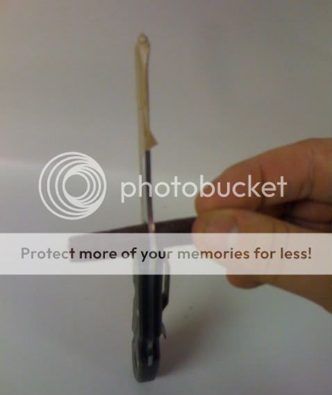

i covered the blades edge and tip with masking tape (safety first) .

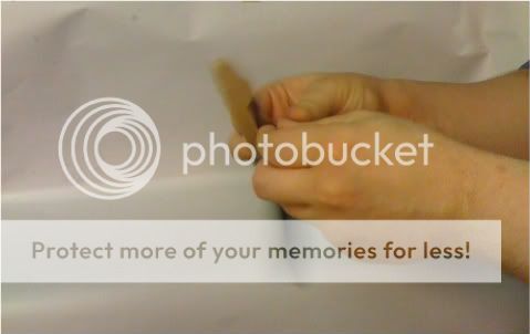

i rolled the sandpaper into a cylinder shape , you can also wrap the sandpaper around a pencil for more stability .
i inserted this sanding cylinder into the spydy hole
holding both ends of the cylinder , i began spinning the knife like a propeller for 45-60 seconds .

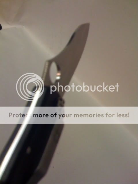

after 45-60 seconds the hole was burr free and polished .

the way i showed above makes the hole perfectly polished and round in 60 seconds or less .
