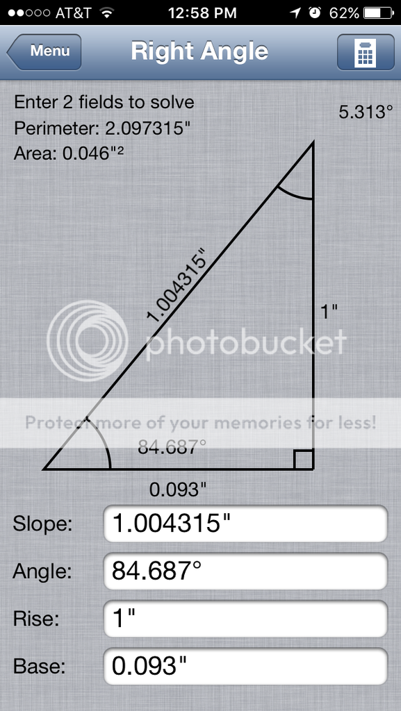

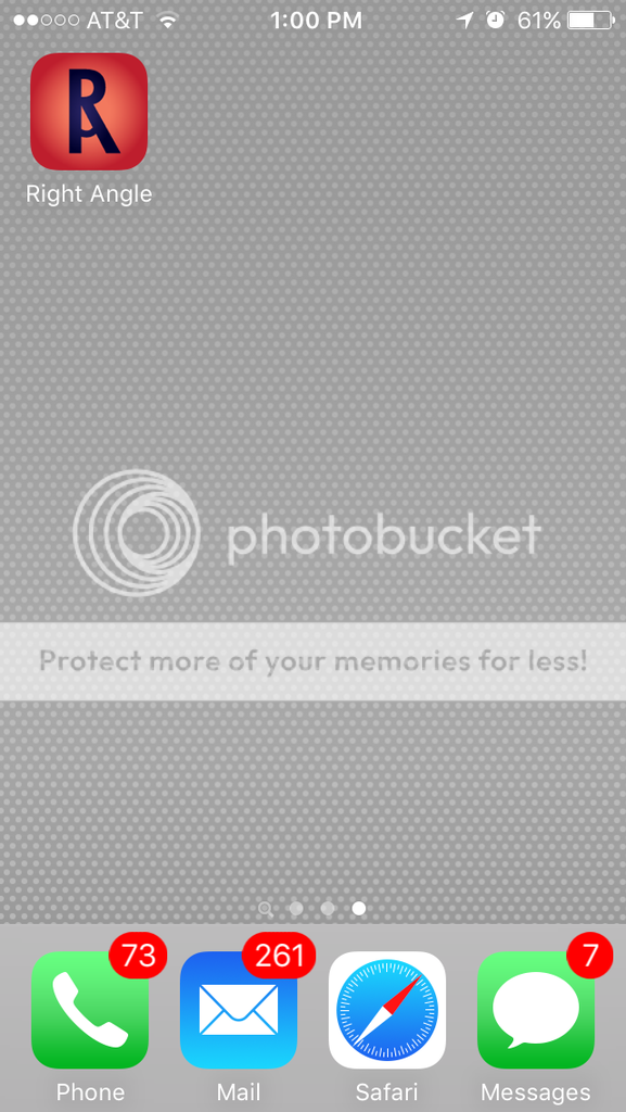

I do like Karaki and figure out where I want the grind to stop by looks. I use an app on my iphone to set my platen angle based off of the thickness and height of the grind I want.
The app is called Right Angle.

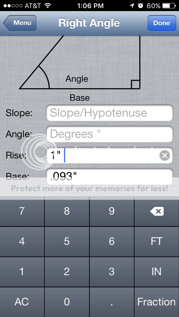

I enter my known dimensions into the fields. For the base, it will be half the thickness of my steel.
Once they are in put done and it gives me the angle after clicking done.

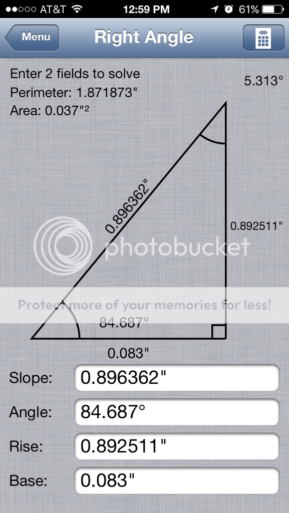

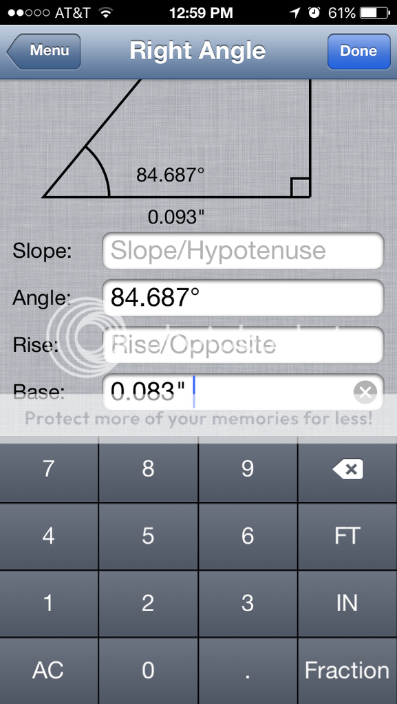

Once it gives me the angles, I delete out the slope, and rise as they will be changing, and subtract .010" from the base so I have half the thickness I want for heat treat. Leaving in the angle and click done. Now I know what my grind height line will be for prior to heat treat. when i'm grinding I can watch this line and the edge scribed lines and I know I will have the look I want when I layed the blade out.
The new height is what I will grind to prior to heat treat. If I set my platten on the exact/close angle I meet both line at the same time.
I do all flat grinds and take my edge down very close to 0 so I'm very very very close to the exact lines of my drawing.
