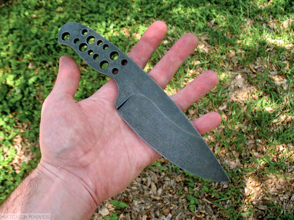

I want to try pitting a blade prior to grinding. I tried Ferric Chloride, but it only turned grey. What could I use to etch some deep pits to resemble an old style knife?

Heat the area you are working with an A/O torch and hammer the surface.
The blade below was treated in this manner.

I was just talking to Stacy about the gun blue/bleach finish. I recently tried this on an O1 blade and it worked well at producing an aged affect. BUT - if you try this you need to be aware that poisonous gasses can be produced from the chemical reaction. So PPE are of utmost importance. Here's my O1 blade after the gun blue/bleach treatment:

I think Shawn see's what is happening to this thread. I do not forge, but rather remove stock. I usually do all grinding after HT unless it is 3/16 or heavier. So, I want to pit a heat treated, profiled blade from the handle forward. Then I would grind the bevels leaving some of the pitting near the spine of the blade.
I would think that a strong acid might accomplish what I want to do. Ferric Chloride did not leave any pitting- just grey metal. But it looked rather nice in grey.
