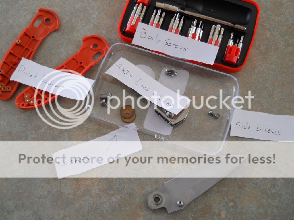

The stuff you need. (The tape is for me. My driver doesnt hold the bits in)
Take out the body screws first, and keep them in a dish or plate, separate from each other.
Now take out the pivot screw.

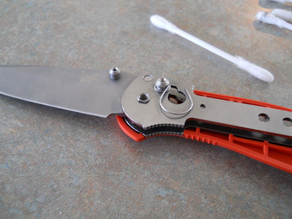

Ok, now for the hard part. Once you're at this stage, be careful taking out the female side of the pivot screw. Don't bend the Omega springs, and don't cut yourself. Push in on the pivot with your fingernail and try to expose as much of it on the outside of the knife as you can. Now, pull back on the Axis lock so the blade has no tension on it, and try to extract it with your fingernails, or pliers.

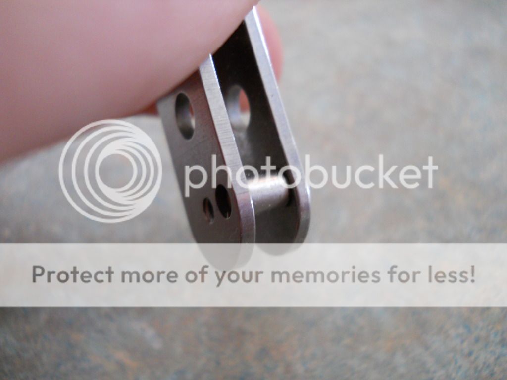

This little standoff is not hooked down, just resting in between the 2 liners. Don't let it fall out on it's own. It will be hard to find.
I don't dare take apart the lock assembly, because I hear how easy the omega springs break. Once it is out, it's easy to clean with Q-Tips anyway.
Make sure to clean around the springs.
