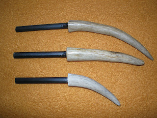

Keep one or more for forming and burnishing leather sheaths.
and this with the rest
Fire steel
