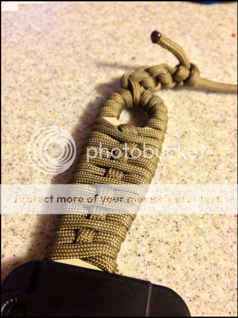

First real attempt at cord wrapping my Izula I am unsure how to end it. A simple knot doesn't seem very secure/permanent
I usually knot it and clip the running ends very short. Then melt the ends, they end up fused to the knot.
After cutting off the end as closely as possible and heat fusing with a heated screwdriver blade, I use one drop of very thin superglue to lock it in place. Don't use thick superglue or you'll be able to feel a hard lump!
