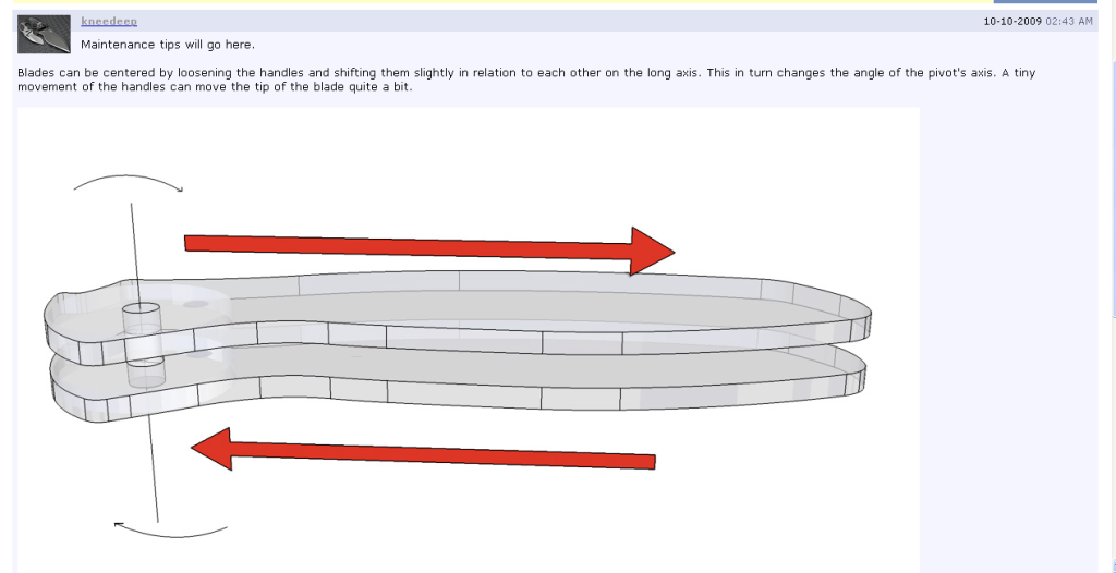

How to center a blade on a liner or frame lock:
1. Hold the knife in your left hand with the blade closed, and the spine of the closed blade upwards (handle spine in your palm).
2. Loosen the pivot and scale/liner screws up to where they are still threaded, but everything is loose.
3. Push the scale against your thumb away from you, and pull the opposite scale with your fingers until the blade is where you want it.
4.) Maintain pressure while you tighten the pivot some, then FIRMLY tighten all the scale/liners screws.
5.) Release your "shifting" grips and see where the blade centers. As you add tension to the pivot, the blade will shift towards the right scale. Find a balance of clearance from the liner, but ease of opening.
There is an EXCELLENT diagram for this, but alas I cannot find it.
I believe it was kneedeep's graphic you are referring to.
Text is as follows:
Blades can be centered by loosening the handles and shifting them slightly in relation to each other on the long axis. This in turn changes the angle of the pivot's axis. A tiny movement of the handles can move the tip of the blade quite a bit.
