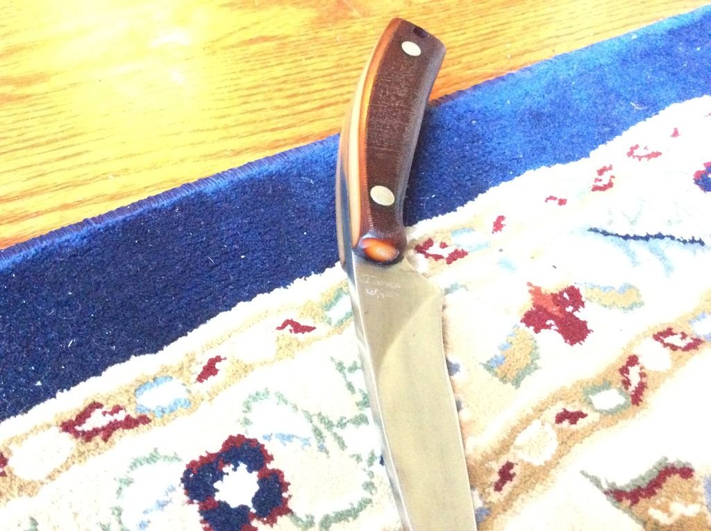

Well I was polishing my blade on my schrade when my hand slipped and it hit the bone handle......
how can I fix this it was my grandfathers before he passed away so I want to restore it
It's the light area where it should be dark where the blade tang meats the handle
First, it's Delrin plastic, not bone.
About all you can do is make the other side match. Plastic is difficult to color.
Assuming that's a Schrade Old Timer, the handles are likely Delrin synthetic shaped and milled to look like bone, and not actually bone. Schrade's Old Timer knives utilized what they called 'Genuine Sawcut Delrin'. It looks like the damaged portion was melted on the buffer (or Dremel?), which wouldn't happen with bone. Delrin is very sensitive to overheating by powered buffing or polishing methods, which will quickly overheat it and cause it to melt, and a powered buffing wheel can quickly remove a lot of material that way. The 'divots' in melted Delrin can be fixed by very careful use of the same method, to reshape it. Could also be done by hand-filing and/or sanding, which would obviously be much safer than trying to shape it with powered methods.
The dark portion removed was originally likely applied via dying methods. There's an authoritative and informative thread on how that dying process worked, which is linked here:

Getting the dyed color back on the surface might be the tricky part. The relevant portion on Delrin, from the above-linked thread, is extracted from the first post in the thread and quoted below:

One drawback of the dyed Delrin is that it is not absolutely colorfast under prolonged UV light. No doubt, you have seen faded handles on Old Timer fixed blades and covers on folders that spent a lot of time in displays under florescent lights, or worse yet, in direct sunlight. I have had some success in restoring the color by burnishing, then applying some light oil to replenish the volatile oils originally in the surface of the plastic.
A “worst case” example came to me with almost all of the accent color gone, rubbed off during years of hard field use by an old hunter. The appearance of the Staglon on this one was somewhat restored by applying Feibings leather dye in several light coats, drying and buffing between coats. As the original dye was composed of both brown and black baths, I applied first the brown, then followed with black. The result was acceptable for a user. The dye did leave a shinier surface than the original, but I could buff it with OOOO steel wool and get a more “factory” appearing finish.

Use a Dremel tool with some fine polishing wheels, to blend the area, and perhaps alter the other side to match. Just go slowly. The polishing wheels can always be found through lapidary suppliers.
Keep the Dremel away from the knife.
Use flat files and sandpaper to blend the area. Buff it smooth with 0000 steel wool.
Since Delrin can be dyed, my choice would be to try Rit dye, mixed very strong in very hot water. Keep applying it with a swab, keeping the dye and handle hot. Wear rubber gloves.
Or, you can try the leather dye.
Glad to know Delrin will take dye!
Y'all are very helpful thx so much I'll try blending it today with sand paper
