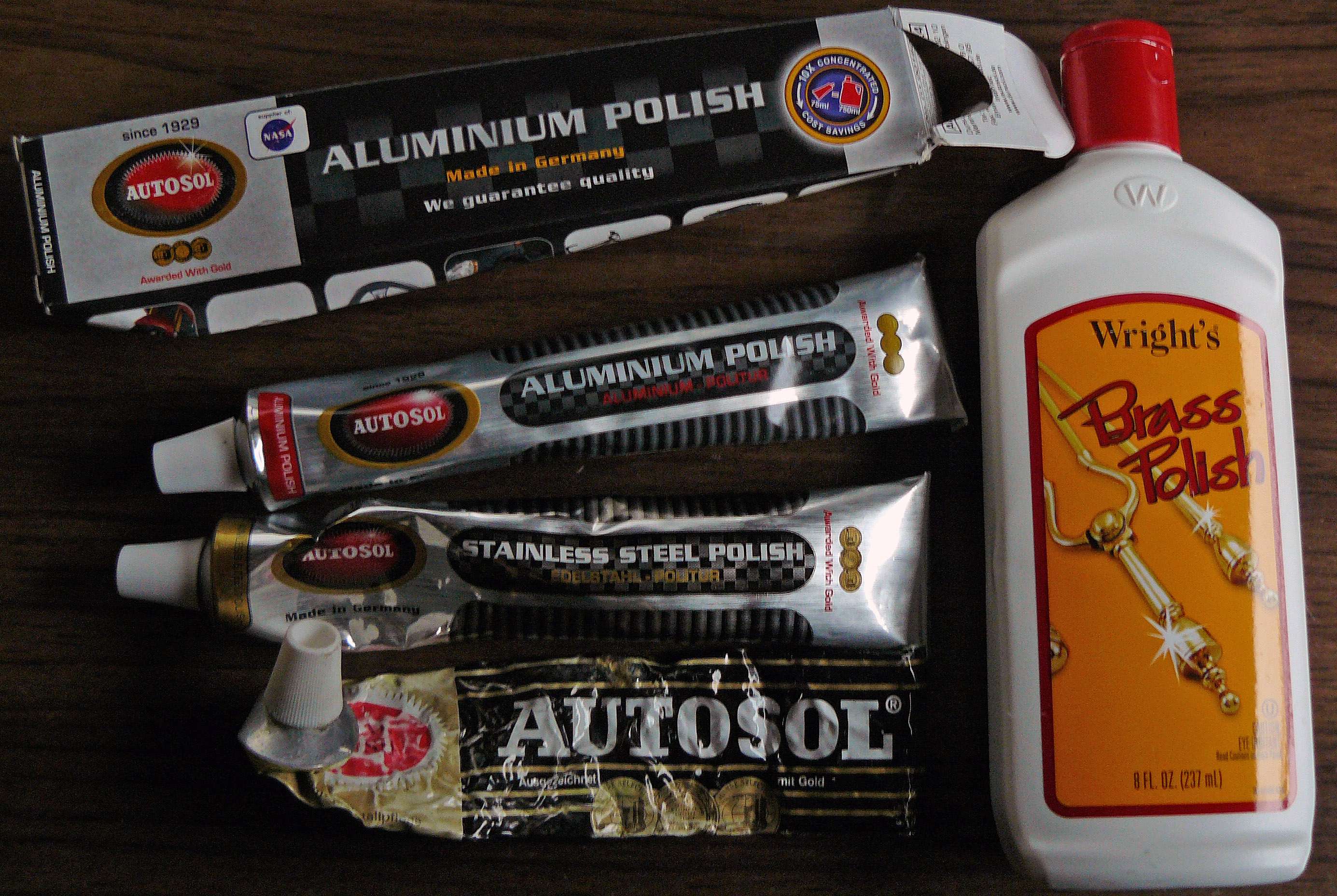

Autosol (a paste) is brilliant. Not seen much in the US. Popular in Europe. Got onto it when I restored a BMW Airhead MC, 1979 100T. It actually removes fine scratches and tarnish. However, Wright's (a liquid) removes tarnish like magic.
