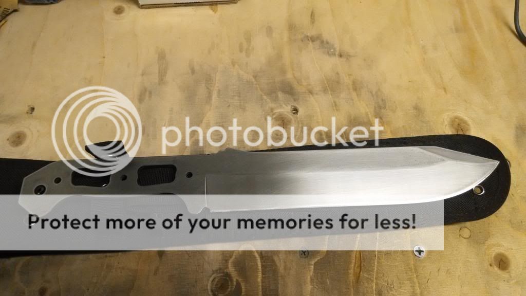

This is a BK9 that I stripped and sanded with 220, 400, 600, and 800 grit sandpaper. Once you get the coating off a Kabar or Condor, in my experience, the metal underneath can be pretty rough. I could have spent more time on a lower grit to get rid of the grinding marks but I only wanted to spend a couple hours on it.
If you want to patina it I highly reccomend putting the blade in lemon juice. I put the above BK9 in a plastic-wrap-lined baking dish with lemon juice overnight, woke up the next morning before work, flipped it over to even the patina, came back 10 hours later and pulled it out. It gave it a very even dark gray patina that I really like. I tried doing the hot cider vinegar patina first which was more complicated and didn't result in as even a patina for me.

You'll have to go by eye. One tip is to sand in one direction then when you switch to a higher grit go in a different direction. That way you can identify the new scratch lines easily. If the older lines aren't getting covered by the new ones you need to go back down a step to even out those deeper scratches. Take your time, even a couple days if you need it. I just spent 2 hours to get the results you see in the picture there and there's still imperfections.
