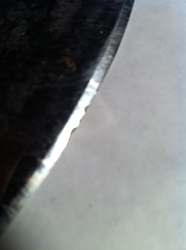

It really depends on what kind of work you are doing and geometry plays a big role. One of the biggest problems is that these European axes, while very nice and made of quality steel with a good ht, usually have a softwood grind. The Wetterlings I used to have tended to bounce off of the hickory and oak I am usually chopping in Missouri and can chip out after going through just a few trees. For carving work they hold an edge as long as a knife with a similar grind would. They can sure power through birch and pine though. For carving, the polished edge excels at removing wood quickly with minimal effort making clean, smooth cuts just like any carving or bushcraft knife.

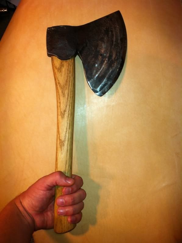

This is my bearded axe by the German smith Mirko Gunther.
I am currently using this axe as well as a custom puukko to make a couple throwers to launch atlatls and it has no problems with chipping for this purpose even though I am using shagbark hickory. I have less experience with more typical American style felling axes, but I'm looking to remedy that soon. I feel that it is worth it sharpen to this degree for a carving or hunting axe, but may not be as important for a felling axe. I really like the pattern of the axe shown. I have used it to fillet a trout just to see if I could and it dressed 2 deer last November so I can attest to the fact that it is very dextrous and can take the head off a buck in one swing without damage fairly easily.
Here's a pic of the chipping from chopping some seasoned oak and hickory.
So to sum it up. It depends on what kind of axe it is and how you intend to use it. I'm in the process of changing the geometry on this axe to a more American style to have more success with lighter chopping work like for firewood collection or fast wood removal for other projects.
