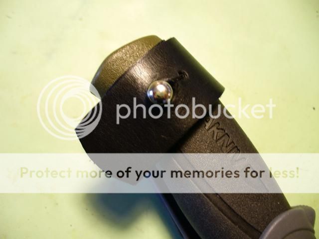

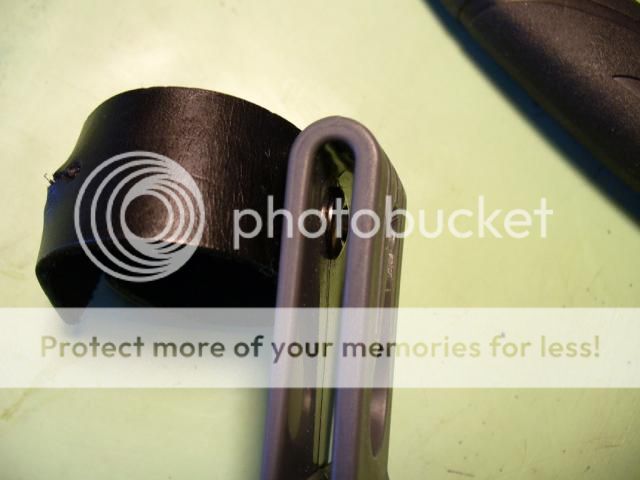

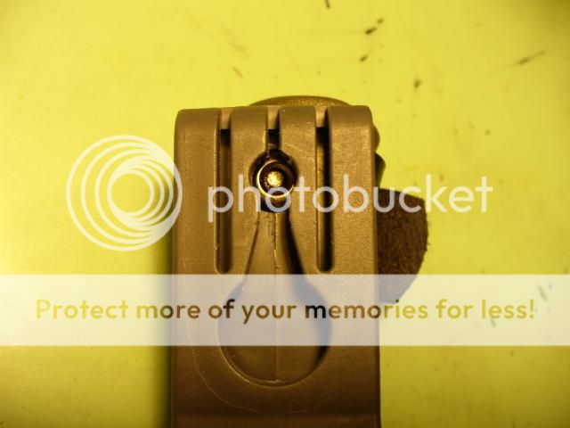

Well for just a few pennies (if you have all the stuff on hand) you needn't replace the sheath anymore as I did for years. Do this! Takes a little piece of leather, a 1/8" Chicago screw and some sort of fastener like a snap or a Sam Browne button. A drop of loctite, a dolop of some sort of leather preservative (Obenhaufs, Mink Oil, Lexol, your choice) and you've got a darn good sheath in just about every respect.
