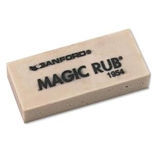

It can be done easily with a piece of 400-800 grit wet/dry sandpaper. Wrap a small piece around a rubber eraser (the example below is what I've used), used as a sanding block. Maintain strokes in one linear direction to keep the pattern looking neat. Works very quickly, and the rubber eraser 'sanding block' will evenly distribute pressure, which makes for nicer-looking results, with no flat-spotting that could otherwise happen if you rub a bit too hard. Anything in the grit range mentioned will give varying degrees of an attractive 'brushed satin' finish.
