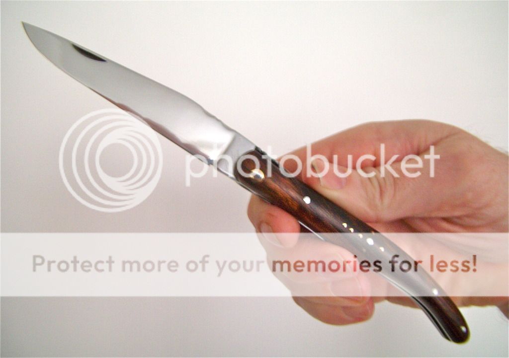

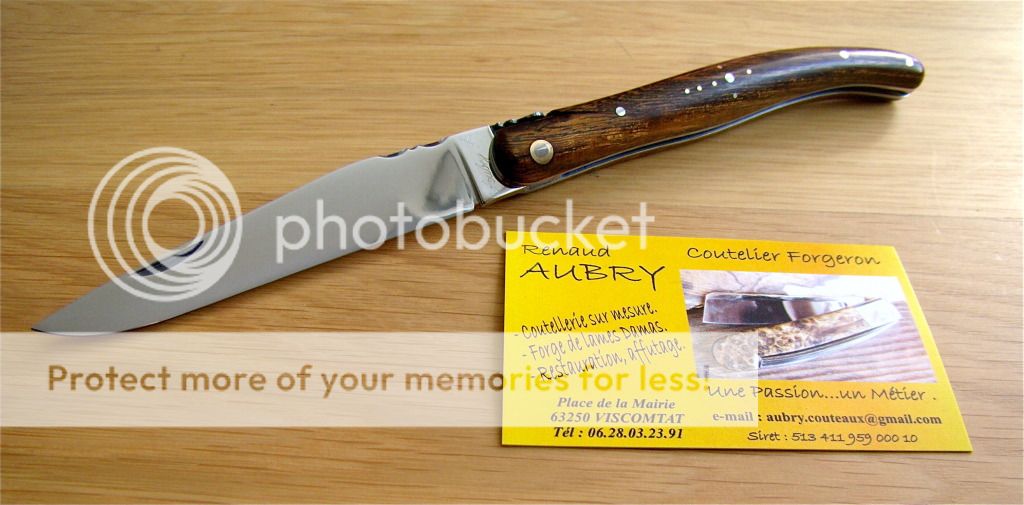

It's the way i use my custom Laguiole (Dutch forum knife 2012)
The blade is 12C27 at 61 HRC while the handle is Arizona Desert wood.
