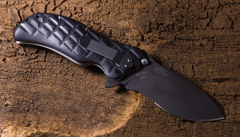

Another idea:
You could give it macro-texture, and still keep the surface highly polished. I warn you, it's a bit of work. Here's a G10 ZT0350 I did kinda like that.
