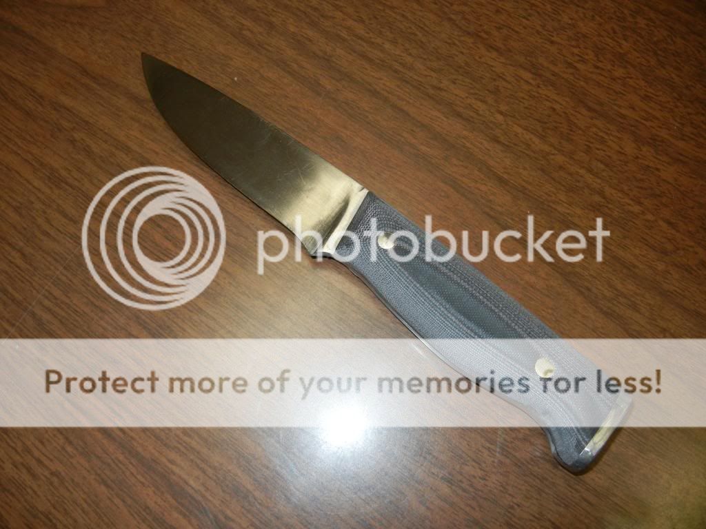

I like it. I can see the red, but not overwhelmed by it. Makes a nice looking scale to me... Good looking knife I think...
