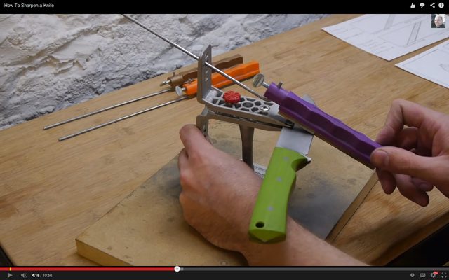

Just for reference here's a couple of my recent videos. I'm proud of these two videos in terms of narrative and quality, but I'm still working on lighting and various other aspects of making the videos.
The first video is a tutorial detailing how to sharpen a knife using the lanksy system. It took about 3-4 hours to get all the footage for this video, then took about 2-1/2 days to edit the video and do the voiceover.

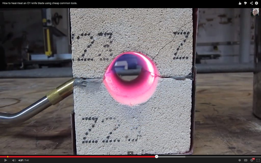

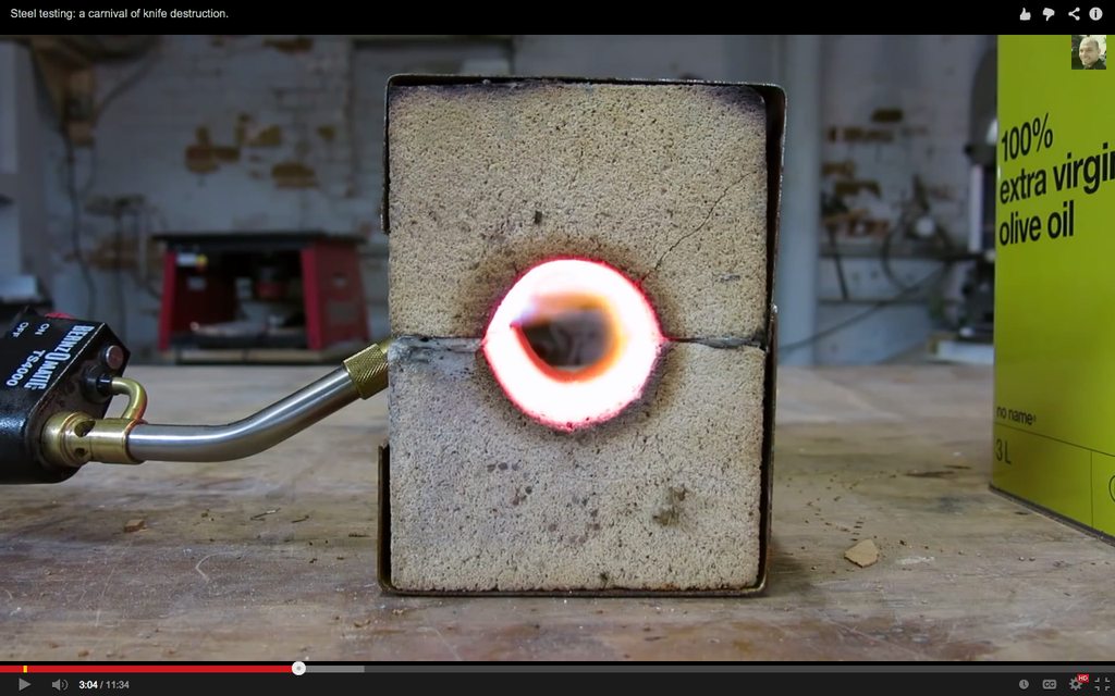

Here is an example of the difference in video between an inexpensive camera and a more high-end camera. These are both stills from video taken in the same place, with the same subject and the same lighting, the only difference is the camera. The differences are a bit more obvious in the videos than in the stills.
First image is from a Canon ELPH100HS (~$100):
Video link: https://www.youtube.com/watch?feature=player_detailpage&v=8bunCG6W6dA#t=278
The second still is from video taken with a Panasonic Lumix G6 (~$750):
Note the extra sharp detail (like the knurling on the blowtorch head) and also the more natural feeling color.
Video link: https://www.youtube.com/watch?feature=player_detailpage&v=TSVs2LCZ-TQ#t=182
As you can see the quality of the less expensive camera is certainly acceptable, but if you're going for a high-end look for your process documentaries then the second camera will make it easier to get that. The more expensive cameras also give you more control over various settings which can become useful as you learn more about how to shoot video, and the look you're after.

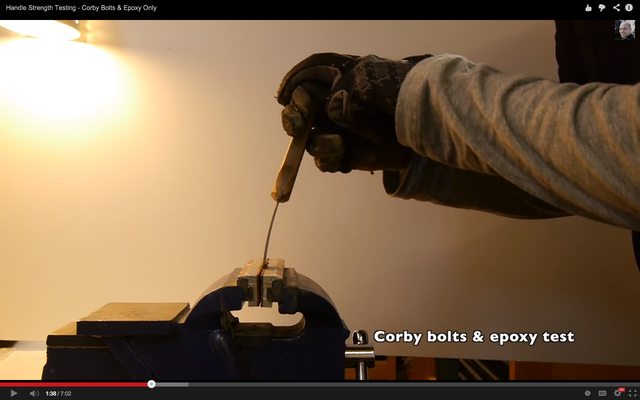

Here is some example video and stills showing both good lighting and poor lighting. Both were taken in the same area of the shop, with the same camera.
Bad lighting:
In this case there is too much light *behind* the subject (my hands) and that has made the subject dark and hard to see.
Video link: https://www.youtube.com/watch?feature=player_detailpage&v=PGmydrLT2Fo#t=98
Good lighting:
In this shot all of the lighting is coming from behind the camera and is also spread out to the sides. The scene is well lit while still showing slight shadows that provide depth.
Video link: https://www.youtube.com/watch?feature=player_detailpage&v=ZlI5PaXsfOk#t=260

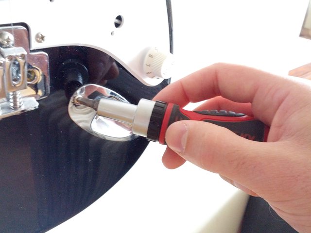

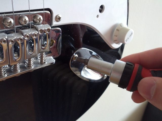

Part 3: Framing your shots
There are a lot of different ways that shots for movies are framed, but for our purposes we generally want to focus on one thing at a time, so simply placing the subject in the center of the shot is usually your best bet.
Sometimes though it will not be obvious initially what/where the 'subject' will be. Assume for example that you're making a video showing belt grinder technique. When you're behind the camera framing the shot your instinct will be to aim the camera right at the platen of the belt-grinder. However when you move to the belt grinder with a blade in your hands ready to grind, your hands will not be in the center of the shot. Given what you are trying to demonstrate it's likely that your hands should be the primary focus, and therefore in the center of the shot. You will learn over time when you need to adjust the frame to allow for things like this.
Bad framing for showing technique:
Note that even though the screw is at the center of the frame, it's not obvious that the screw/screwdriver/hand is the subject of the shot.
Good framing for showing technique:
Now we have the screw/screwdriver/hand as the primary focus of the shot. Getting this kind of framing is obvious in a lot of cases, but may take more thought when you're not initially in the shot because you're setting up the camera.
