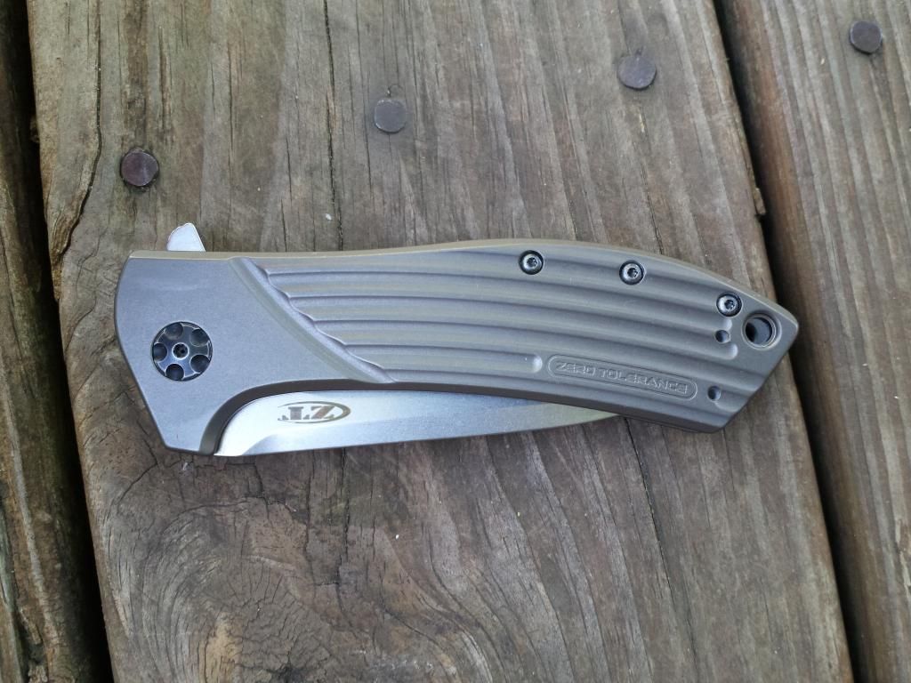

I found this pic on the forums and would like to try it. The owner of the pic said he oxidized it. Anyone know how to oxidized titanium?
Thanks,
Shayn
I don't think it's heat anodized because it would be a lot less uniform. My guess was electric simply be a use of how consistent the color is.
He said oxidized, not anodized. I remember people asking (maybe even me) how he oxidized the titanium in the thread. It was awhile ago. I guess he never answered.
Anodizing is oxidizing. It is not an alternative finish to oxidizing. Anodizing is just a process that oxidizes the titanium in a very controlled form. In both cases the titanium develops a layer of titanium oxide on the surface. I'm guessing the oxy-clean produces an nonuniform oxide layer that does not refract light at a specific wavelength, in other words, no color.
Well I gave it a shot and here are the results. It looks a little darker in person, but not as dark as I was hoping.
