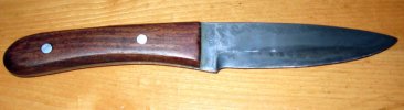

Warm vinegar and mustard is what I used, applied and let dry, rinse with cool water, got a picture around here somewhere.......R-10

Well I just finished and all I can say, is I am IN LOVE with patina. Thanks to CPL punishment for the idea, and H20 for the help.
I soaked it in a rag soaked in vinegar for about an 30 minutes, then just dobbed a towel and kept wiping it down until I got the desired darkness. I wish I had my camera, but I will soon. I like this look alot more then then shiny metal it once was.
I couldnt find much on process, so I just sort of winged it, and it turned out BEAUTIFUL. I want more high carbon knives just to patina them :D
