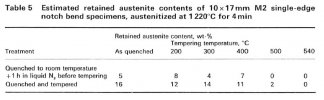

A typical 1050°F double or triple temper largely eliminates all of the retained austenite:
So far I'm at 2200 and plate quench, cryo, 1000 temper, cryo. I will just finish up the next 2 2.5 hour tempers.
Per your cart this should put me close to 66Rc. If its chippy at that hardness what do I adjust.
I wouldn't be so sure about that. This might be old information here, how old is this literature?
I'm working right now but when I get chance I'll dig out some specific information for this thread, but I'm pretty sure that M2 is typically 20% RA in the finished fully heat treated tool. The application of x ray crystallography has changed some of the perceptions about RA but isn't widely available in some of the older texts.
I look forward to the reference. X-Ray diffraction is the oldest and most common measurement method for retained austenite, including with old literature.

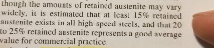

I spent over an hour digging though my books and didn't find the specific reference I was looking for. It's possible it's not even in my literature and I've seen it on line but I recall reading that an industry standard heat treat for M2 (does not include cryo, does include three ~1000 tempers) leaves about 20% retained austenite in the finished tool (endmill or drill etc)
This note, from current literature, comes pretty close to that:
I have noticed that references created in this century frequently give higher retained austenite estimates than older 20th century texts on the same alloys and the reason for the discrepancy being improvements in the techniques (x ray crystallography) used to measure it. For example I could probably find a reference for D2 showing perhaps 5% in a particular scenario in an old book but perhaps twice that for a similar scenario in a more current book.

Perhaps the commercially produced steel uses few tempering cycles or short tempers; don't know. X-ray diffraction was discovered in 1912, and major studies on steel with XRD started in the early 1920's. The fundamental capabilities of the equipment haven't changed substantially in many decades. There's no reason to distrust something just because it didn't come out after 2000.
Here is a 2001 paper on M2 showing ~15% RA after a double 1h temper at 540°C (1000°F), and ~7% with double 1h temper at 570°C (1050°F): http://mit.imt.si/Revija/izvodi/mit015/leskovsek.pdf
Hey I'm out in the shop on my phone I can't really see this very well, could you give me a brief synopsis, does this newer information contradict the older tables, I'm just curious?
The closest 1:1 comparison would be with the double 1h temper at 1050°F. The old table shows 4% and this paper shows 7%. Pretty close I would say.
