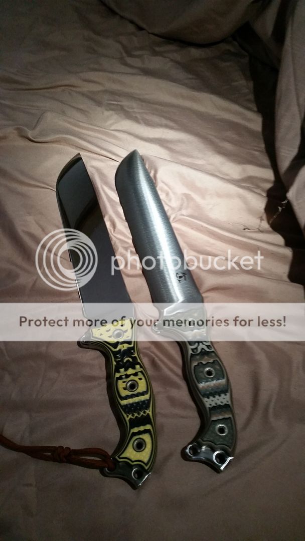

I mirror polished the one on the left. Took a few hours spread out over a few days.
I used regular sandpaper, wet dry stuff.
500, 800, 1000, 2000, 3000, 4000, and 5000. Also mothers metal polish.
It's not perfectly mirrored, as I keep using it. I just like it shiny enough.
