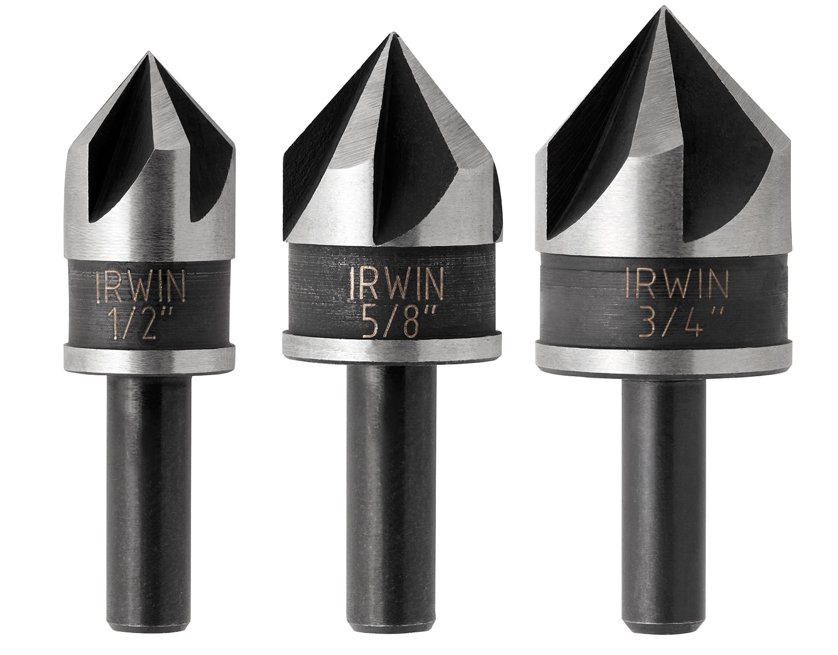

Going straight from a bumpy milled surface to a polished one in one step with polishing compound might be a big ask. Some countersinks leave smoother bevels than others.
I have never had good results with the old fashioned multi edge engineers countersinks.
I have had better luck with a new, sharp, three blade cutter, but have heard some others give even better results. Quality definitely matters. I have found that using the same countersink to hog out general countersinks then hoping to get a super finish from it does not work well. I now try to keep one or two sinks just for finishing. Running them hard into the edge of a drilled hole can cause dinks in the edge that translate to lines on the finished bevel.
I have only a small carbide countersink for my smallest of holes, but that gives the best finish of the four sinks I own.
As an intermediate step I have had good results using a 90 degree carbide burr. My countersinks are also 90deg, angle matching also matters. Only then do I go to the bevelled rod and compound. I file some grooves into the bevel to help hold compound too. Diamond lapping paste worked better than the other polishes I have on hand.
Still slow, but not as bad as trying to take a bevel off my roughing sink straight to polished.
