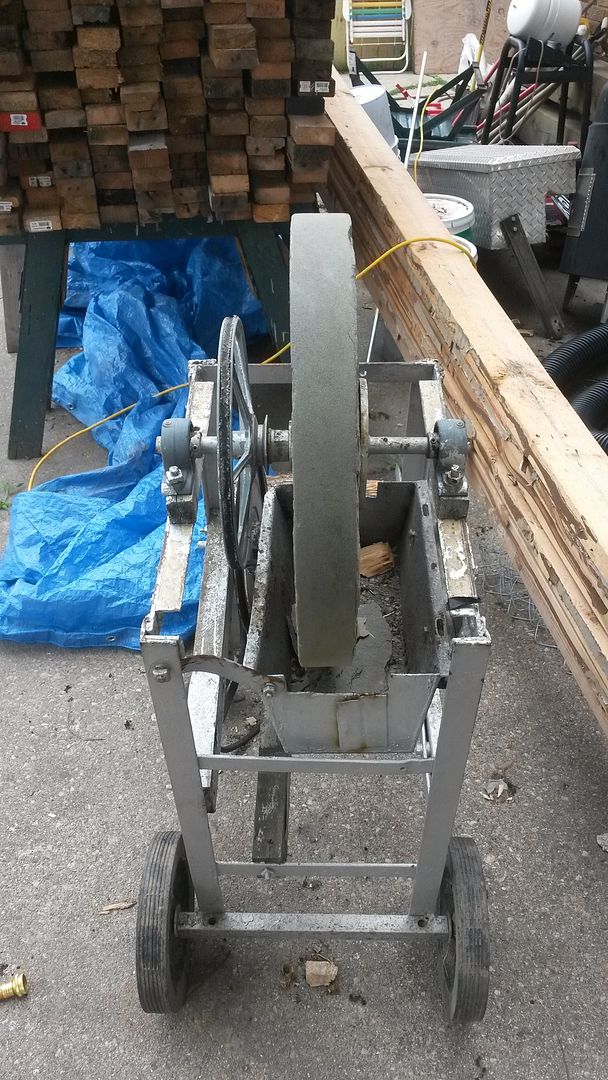

While I'm on the subject look what I found. Someone was using it as a lawn decoration and I got it cheap.
[/URL][/IMG]
That looks completely haome made, from welded angle iron to a cast cement wheel. If it works well that is awesome.
yes i do believe that it is home made. that being said it does have a trough for water and if i hooked it up to a small electric motor it would work fine
Wet grinder is the way to go. You need a motor and some new belts. You can calculate the ratios for those sheaves or just try it with whatever sheave comes on your motor and make adjustments as necessary.
I've read about homemade cement wheels but not seen one before. Cool!
