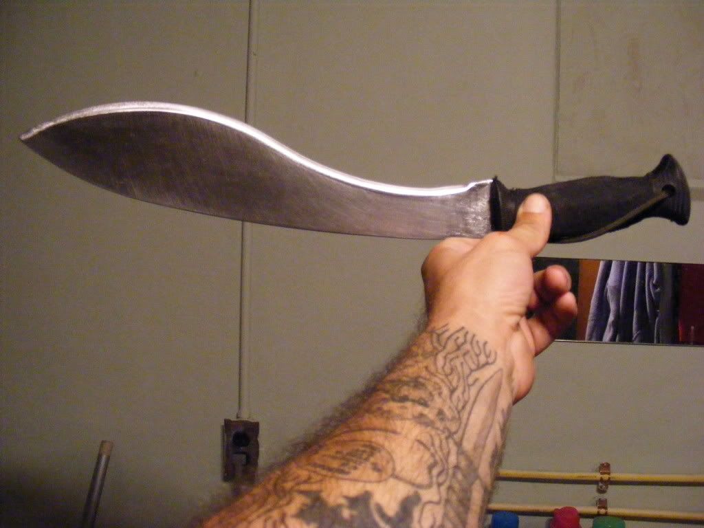

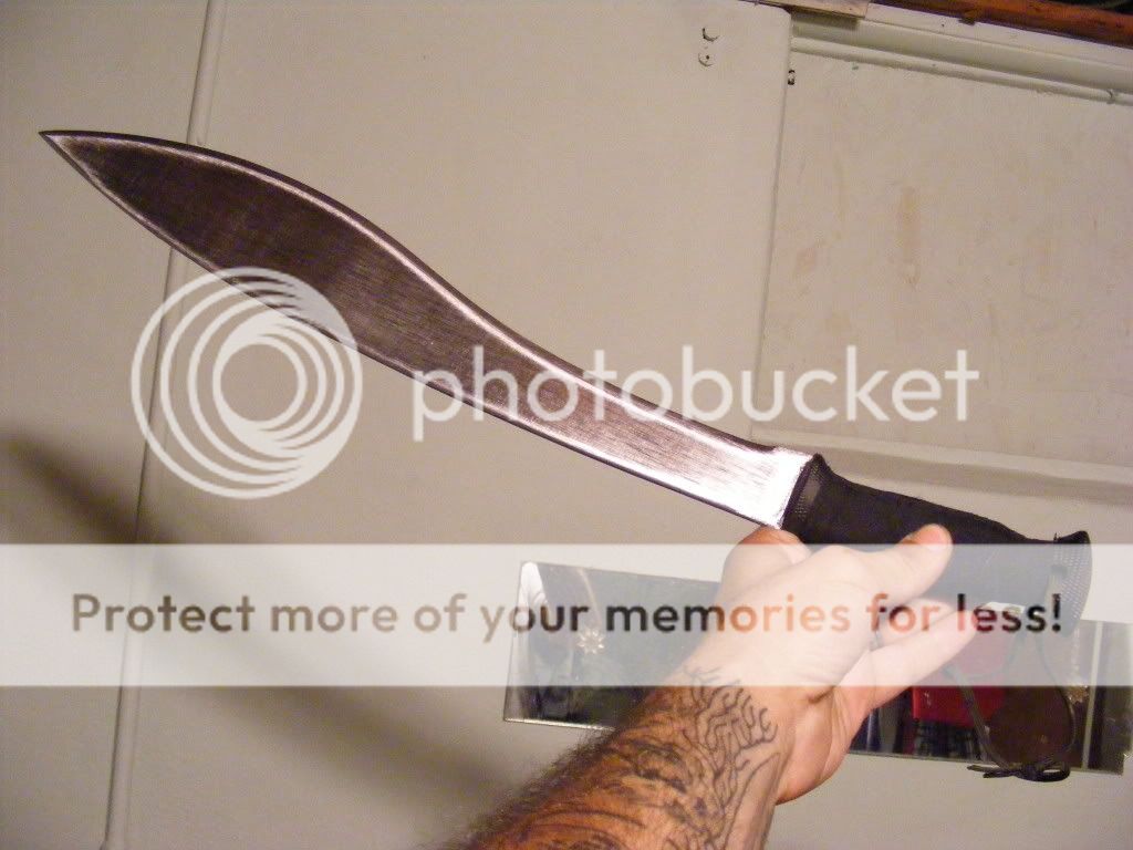

Here are two Cold Steel Kukris (one normal, one Magnum) that I used an orbital palm sander on. 100 grit, then 150, then by hand with a 200. Then an 800 emery cloth by hand, ands finally a coating of simichrome polish. They're still not mirror polished, but I like them a lot better than before.

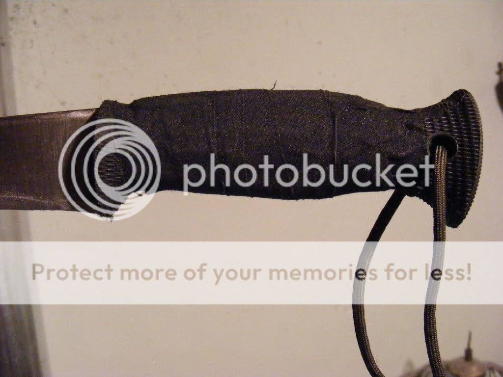

I sanded, then wrapped the handles in athletic tape for a less blister-prone grip...
