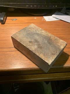

I found a rather beefy wetstone in a restaurant cellar awhile back. I suspect the stone is from the 60's or maybe even older. I don't know why a wetstone would be so thick at only 6" long. Overall dimensions are 6" X 4" X 2" , and appears to be mostly flat and fine textured. Is there a certain kind of file required to flatten it, or can I use sandpaper on a flat surface? It seems like a soft stone, and I'm not even sure it will sharpen the supersteel knives i tend to carry.
What will the usefulness be with a soft, perhaps 1200 grit stone? Also, how do I determine if it really is a wetstone, or oiled stone?
Thank for any insight!
If it is a water stone I would pick up a 400/1000 diamond plate to flatten/clean it up. A diamond plate is a very convenient thing to have anyway and not very expensive.
Some popular method to flatten whetstone are:
1. Use sandpaper on a flat surface, your kitchen countertop should be plenty flat
2. Use loose abrasives and a flat surface, usually on a dedicated glass plate because you'll scratch the plate also.
3. Use a coarse sharpening stone to flatten a sharpening stone, I am currently using this method and had had good results.
4. Stone flattener/fixer, either diamond plate or a dedicated stone fixer.

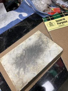

So I first used a coarse file, to try and remove grime, and not much shaping happened. Next I used 100 grit sandpaper on a marble tile. After 3-5 minutes, I got this:
I sprayed the whetstone with heavy duty degreaser, and continued for 15 more minutes, changing out the sandpaper when necessary. After awhile, I saw the flattened, high part of the stone was really polished, almost glazed or porcelain-like. Next image shows the stone after trying it out on my hard-to-sharpen Manix 2 with CPM S110V.
Since I couldn't see distinct "beading" when I wetted (whetted?) the whetstone with water, I used it to sharpen my knife with water. I cannot tell if it is a "hard" or "soft" stone from just one use, but it took a long time to get it close to flat with 100 grit aluminum oxide sandpaper. What I can tell, though, is that it put a really keen edge on the S110V! This has been the hardest to sharpen knife that I own. I recently bought another Spyderco device, the Combo stone, and it helps A LOT for me, especially with M-4 and C20V. But the file grit of this antique stone will be fun to figure out. Thanks for the advice.
A file is just going to be ruined on a sharpening stone. Your stone is probably made of aluminum oxide, and you glazed it by using sandpaper of equal hardness and it's also why it took so long. The stone is now so fine because the knife is now mostly just gliding over it rather than being abraded. If using sandpaper on it (not a recommended method) you'd do better using silicon carbide. Silicon carbide is effective on silicon carbide stones using the loose grit method because it is functioning under 3-body abrasion rather than two-body like with sandpaper. A diamond plate can also be used, but will still be slower than the loose grit method and will put significant wear on the diamonds.
FortyTwoBlades FortyTwoBlades fully right, yes, there is also a problem with aluminum oxide stones, if you rub them with other aluminum oxide stones or sandpaper, then their surface layer is smoothed and, in fact, deteriorates, it really glides like on glass. It is best to use a piece of glass and silicon carbide powder. It's cheap and readily available. One thing is clear for sure, this is a hard stone. A soft stone, even on sandpaper, would give off a lot of powder / slurry. Today I was putting some very hard stones in order, silicon carbide is just a salvation.
That's literally what I was describing, yes. Abrasives of the same type rubbing against one another results in the grains being worn down and dulled, causing the stone to glaze.
Does silicon carbide come in various "grits"? Which should I use, or how do I determine which one will fix up this stone? I just read on Wikipedia that silicon carbide stones have been in use since 1893, so mine could be really vintage.
Even in its glazed state, it works to fine tune some edges. Now I really want to fix it properly. Thanks for the tricks.
You really don't want your stone glazed. It'll just rub the steel, pushing it back and forth instead of abrading it, and this induces fatigue at the apex, resulting in reduced edge retention. Your stone is not silicon carbide, as silicon carbide is either black or grey-green (referred to as "green" silicon carbide.) Yes, it comes in various grits, but also breaks down into finer grit quickly, so you'll generally do best with approximately 60 grit black silicon carbide.
