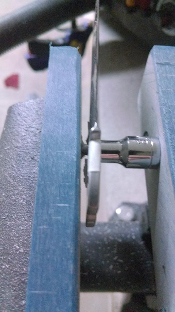

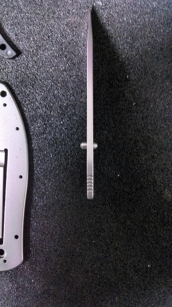

Don sent me this knife to work on and it is indeed painful to open. It is a press fit thumb stud so I thought I'd show how I pushed the thumbstud over using a vice and a socket slightly larger than the stud. This helped but its still pretty tough to open because of the strong detent.

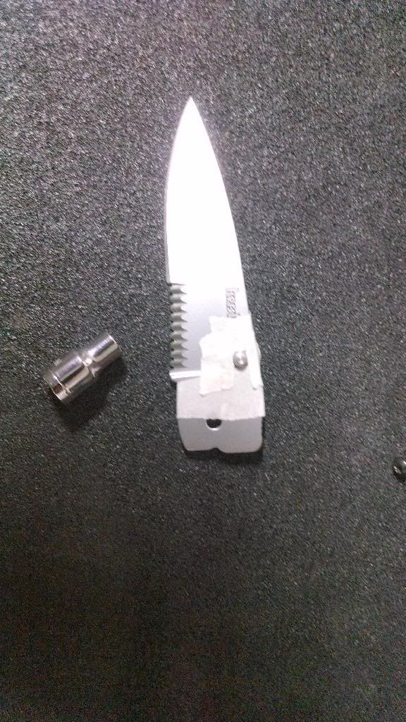

The socket goes over the side of the stud that you want to be sticking out more.
The blade and the other side of the thumbstud are protected with masking tape and then you just slowly tighten the vise until the thumbstud moves if you want to take it out completely just keep going all the way and it will fall right out.
