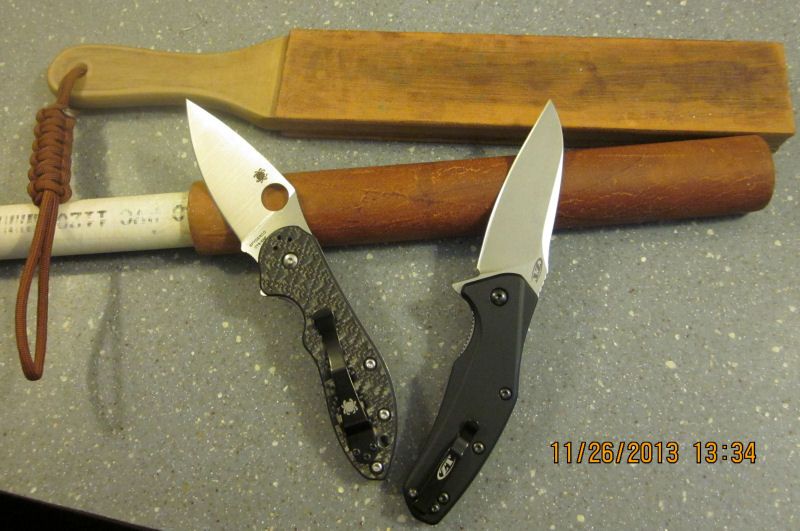

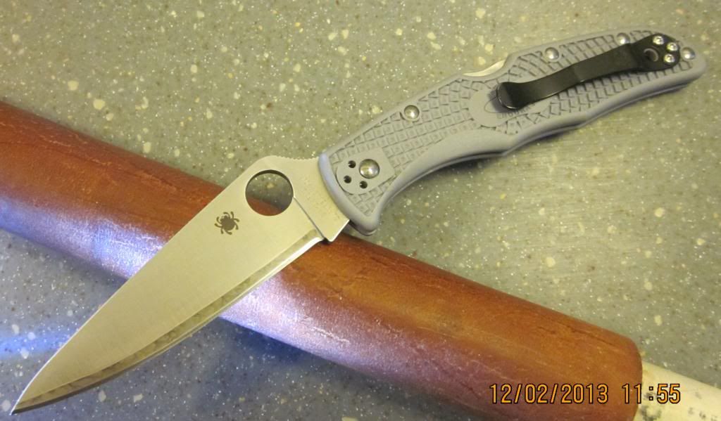

I only have one knife with a recurve blade (the ZT shown in 2nd pic) and I never carry/use it. I did make a rounded leather strop for recurves "just in case" and haven't even charged the strop with any compound yet. But if I ever need to touch up the blade I can do it without too much effort. I just cemented leather around 1" PVC.
I think that the SharpMaker should work well on recurves as other posters have said. I have absolutely no experience on stones...outta the ball park for me. As stated in many other places on this forum, strops refine already sharp knives and won't sharpen a dull knife. Just had a couple of pics hanging around so why not share them?
