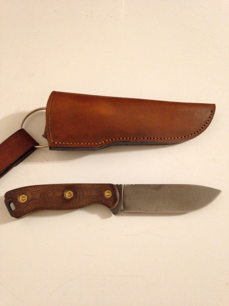

Don't have any before pics but here are a couple of crappy after ones.
I used the hot vinegar approach on my 15 after masking the handle and applying a stripper. Came out a dark grey that I really liked. I'll need to get pictures up eventually.

I used aircraft paint remover on mine with blue tape on the handle to preserve the coating there. It came out fine, I use it for food a lot.
