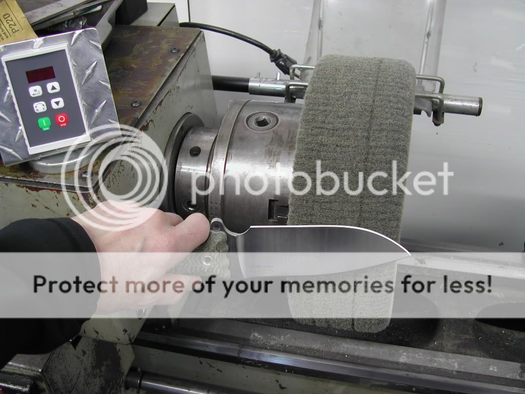

Here is what I use, a 4" wide X 12" dia. Scotchbrite wheel on my lathe. I know, it isn't practical for most people, but I just got a old snake skin Active Duty that had some bad kydex marks on it and it did a good job of buffing them out without polishing the blade, kept the original logo in place too (that is of course not the AD I was talking about, just the Scotchbrite wheel I am referring to). :eek:
Here is what I use, a 4" wide X 12" dia. Scotchbrite wheel on my lathe. I know, it isn't practical for most people, but I just got a old snake skin Active Duty that had some bad kydex marks on it and it did a good job of buffing them out without polishing the blade, kept the original logo in place too. :eek:
one raccomendation... don't use the scotch brite weel directly on the edge. it will make your knife dull.
