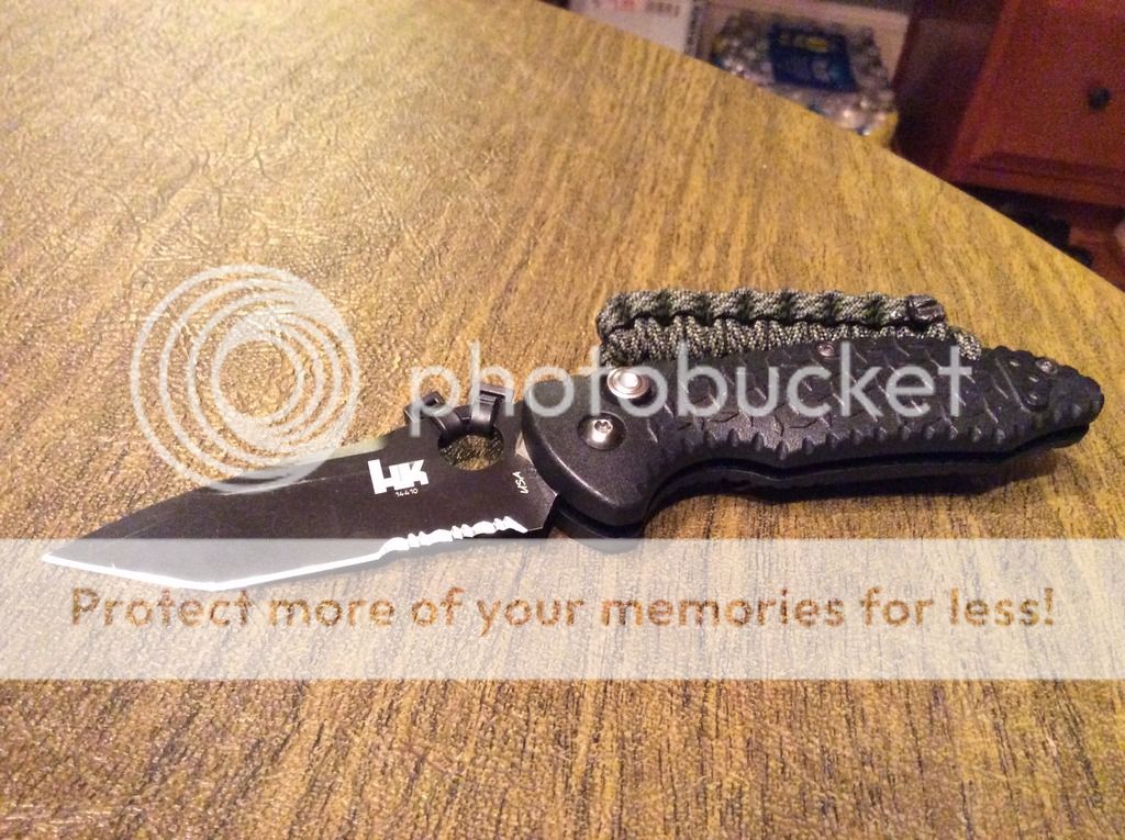

I know it's not that popular but any of u have pics of the hk soldat without the coating this is what it looks like now
