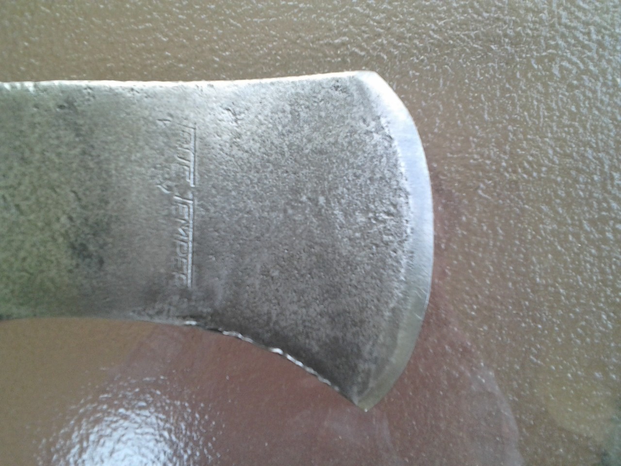

Hi all. This feels like a stupid question, but how can you tell if a bit is worn out? I have a few old axe heads I was thinking about fixing up and using, but I wanted to make sure the bit metal isn't too worn down. Honestly, I can't tell the difference by looking at it.

Okay. It looks old, but I’m not sure I would be able to tell the visual difference between worn and not warn without a brand new example sitting next to it.
I’ll try the vinegar bath. It’s got a deep black patina right now, so maybe it’s hiding the quench line. (The axe I’m working with is a Kelly True Temper Vulcan Double bit, by the way)
I always pay attention to the toe of the bit, which is the upper tip of the cutting edge. It should extend out further from the handle than the bottom tip (the heel). Toes get chipped often from striking the ground, and then have to be filed back to eliminate the chip. This gives the toe a big rounded curve. Also, improper sharpening will accentuate the curvature of the bit over time; these axes I tend to avoid purchasing or restoring.

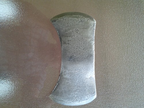

Well, the Vinegar bath really made a difference. Unfortunately, I still don't see a quench line. The toes and heels of the bits are about in-line.
I might put this one aside and work on my flint edge instead. I just really can't tell.
Alright, let's see if this works...
The toes are heavily worn on that axe. Just the same, you've probably got close to an inch of hardened steel remaining.
Even if the the vinegar doesn't show a quench line the file will still tell you for sure how much hardened steel you've got left.
Okay, thanks for the help. As long as it's useable, I'm happy. This is the first axe I've tried to fix up, so I don't need perfect. Especially since I didn't pay much for it.
I think overall you'd want to take some of that roundedness out by focusing on filing back the center some. Here's one that I did that kind of shows the progression.
