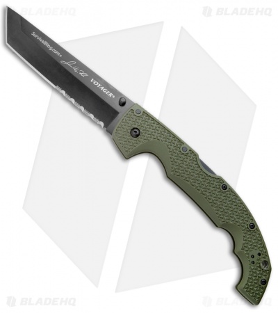

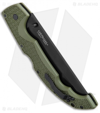

I recently bought a Cold Steel Rawles Voyager on eBay. Then I noticed something odd. The left side of the blade looked fine (as well as any chisel grind can look fine), but when I looked at the right side, there was nothing. It had the DLC coating, but that was it. There was no writing. No "Cold Steel" or "Taiwan" or "CTS-XHP." The answer was obvious.
I'd been had. It was an obvious FAKE! A counterfeit.
Or was it?
I contacted the seller and left my phone number and later in the day got a call. The knife, he said, was quite genuine. He'd ordered a number of them right from Cold Steel and he offered to send me a copy of the receipt. He said he'd given me a good price on it because the box was a bit buggered and it had been returned. And the knife did look and feel like the real McCoy. So my good nature prevailed and I believed him. He was a nice guy.
But then my suspicious nature emerged. Not towards the seller. I began to suspect the fellow who returned the knife. Could it be that he ordered a knife, but had returned another? There were things that didn't look right, but I determined to ask here. I'd just bought a Frenzy a week before and the new box was expected. Not the sky blue one but the new black one. The Frenzy box had a label affixed to the side, but this knife's label was printed on the flap.
The size of the retention screw also was a smaller hex size than the ones in photos. And the thumb studs were close, but not quite right, and the slotted stud was on the left side of the blade and most of Cold Steel's slotted studs were on the right side.
So my question is, how likely is it that I got a fake? Am I making too much out of these things? Perhaps they forgot to stamp the right side of the blade with the company name, the name of the country and the steel? The whole right side was jet black. And if it was genuine, do I have a collector's item? How uniform are the retention screws? Does the fact that it takes a slightly smaller hex driver a sign of perfidy? The scale pattern is assiduously correct, and the serration pattern is...well, very Cold Steel.
I know the counterfeiters are paying a lot of attention to detail, but what of the missing information on the right side of the blade? Is it worth me asking him to exchange it, which would be a pain? What do you think? Have I been had?

I contacted the fellow who sold me the knife. Very nice guy. Very eager to please. He said at first that it was no counterfeit, that he'd purchased fifteen of them directly from Cold Steel. He even offered to send me a copy. But he'd sent the knife out to a seller, who then returned it. I called COLD STEEL and talked to a fellow named Corey. He said that many of their dealers have sent good knives out only to have them returned as fakes.
The seller didn't want to think the guy who returned it would do such a thing, but the evidence was overwhelming. Nothing on the right side of the blade. No logo, no blade steel. Just the black coating. Next giveaway, the pivot screw was of a non-standard size. I got out my box of CS knives and photographed the knives showing the pivot screws of all of them next to the suspect knife. It was 1-2 sizes smaller (not the screw, the hex size). I even had an old Night Force knife from years ago. The pivot size was standard. Next, the spine spring was recessed into the frame. Actually it feels kind of neat, but definitely not CS tolerances. Finally, the thumb studs had the screw slit side on the left and not the right side of the blade. And it wasn't deep. I next got a photo of a fake knife and created an inset, illustrating this. Thus, on two photos I pretty much put together an airtight case.
And BELOW are the photos of the counterfeit knives on the left, and the knife I was sent on the right. The slotted thumb stud is on the front of the knife. In most COLD STEEL knives, it's on the other side. Added up, the knife's a counterfeit.
I did not want to trudge down to the Post Office to return the knife, so I offered him the price the fake knives were going for on eBay ($29 plus) and determined to keep it. Since I carry these knives for self defense much of the time, it will serve its purpose. Also, to be honest, the blade steel is very sharp. I've bought cheap 440A knives in the past and the bloody things could never GET sharp regardless. Maybe it's 420J2 for all I know. That and all the 420s I've seen can be sharpened, but they quickly lose what sharpness they have.
I suspect that within a year, these fake knives will be completely indistinguishable from the real ones. They're already close. The sellers maintain the steel is D2 (rhymes with "It could happen to YOU!"), but I could call toadstools mushrooms. Who knows? The coating looks dead on to what CS is producing.
