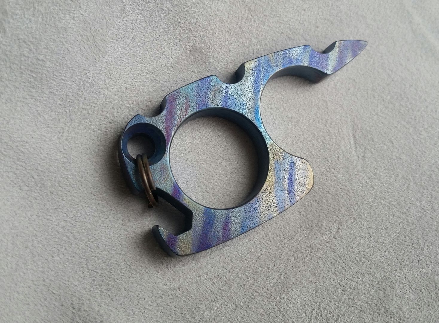

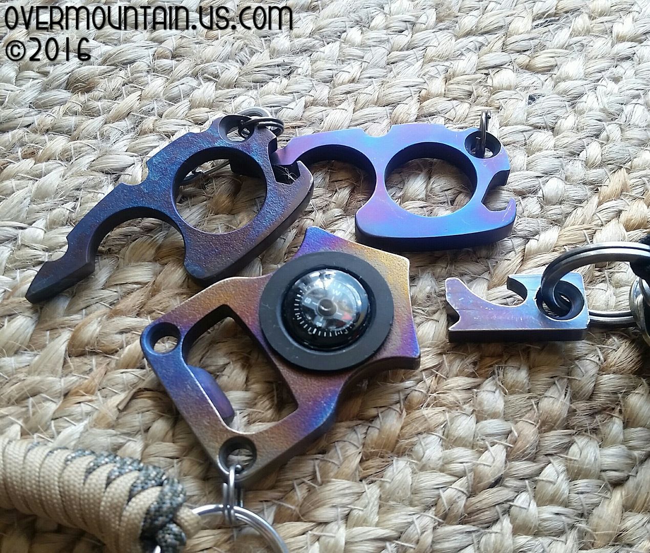

This is what we are after...
If you aren't keen on the brighter colors, just bear in mind this follows the tried and true 'v=color' spectrum. Dull shades are doable as long as you stick around the 20-30v range.

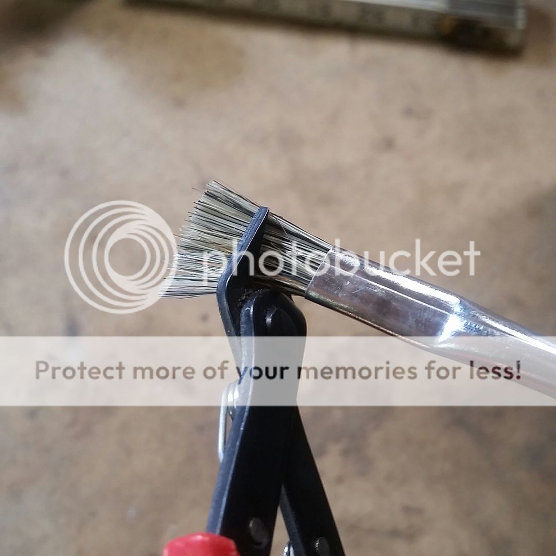

You will need aluminum foil, wires with gator clips either on both ends if doing the 9v battery thing or on the leads from the power supply if you have one. I use saltwater with just a touch of vinegar in it for my electrolytic solution. And for a paintbrush, I use the cheap 'acid' brushes as they have a solid metal tube and come in big packs for a few bucks.
You will need to cut the bristles down so they don't have to carry a huge bead of liquid to pass current. Biggest thing is to make sure they are even so you don't have any wierd flyers.

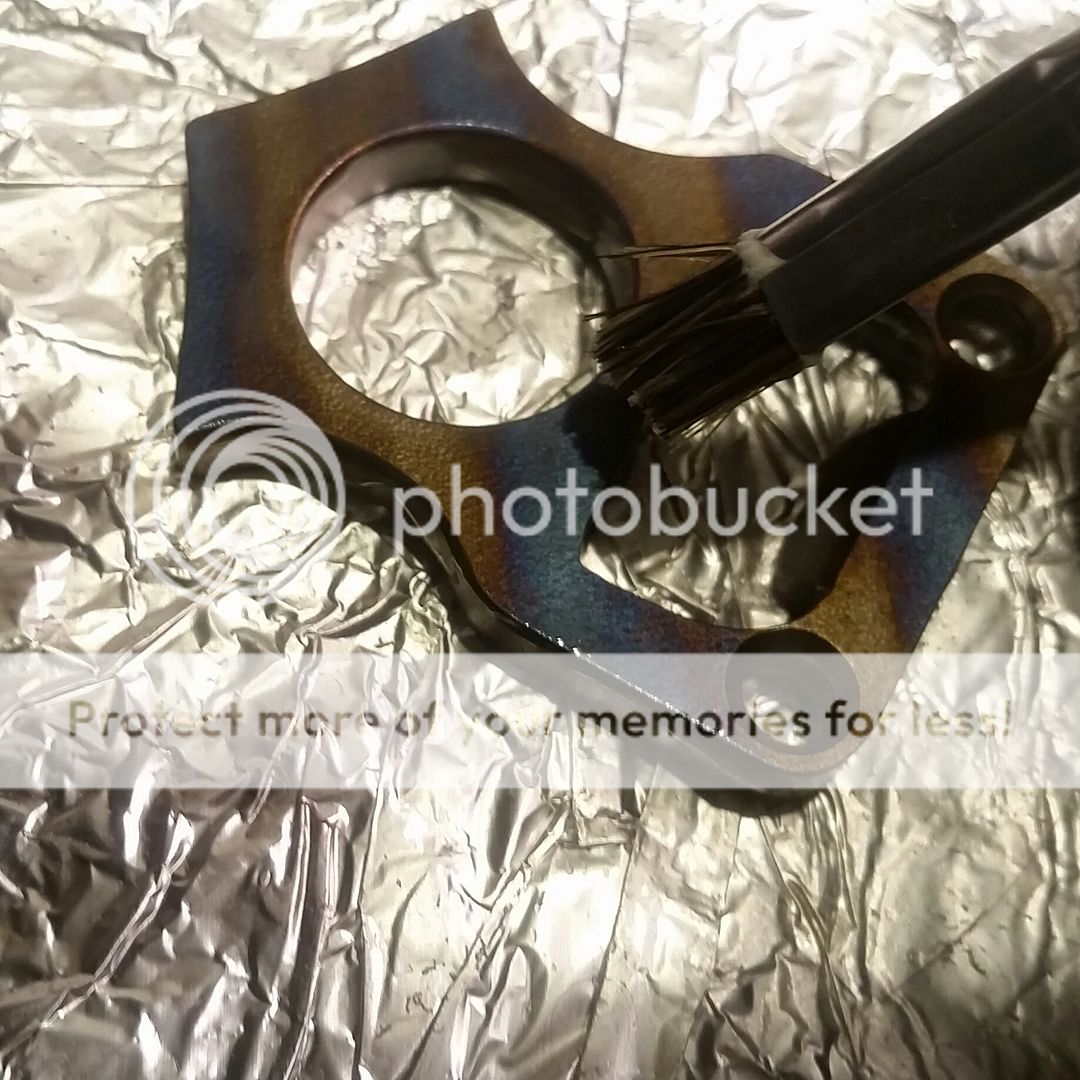

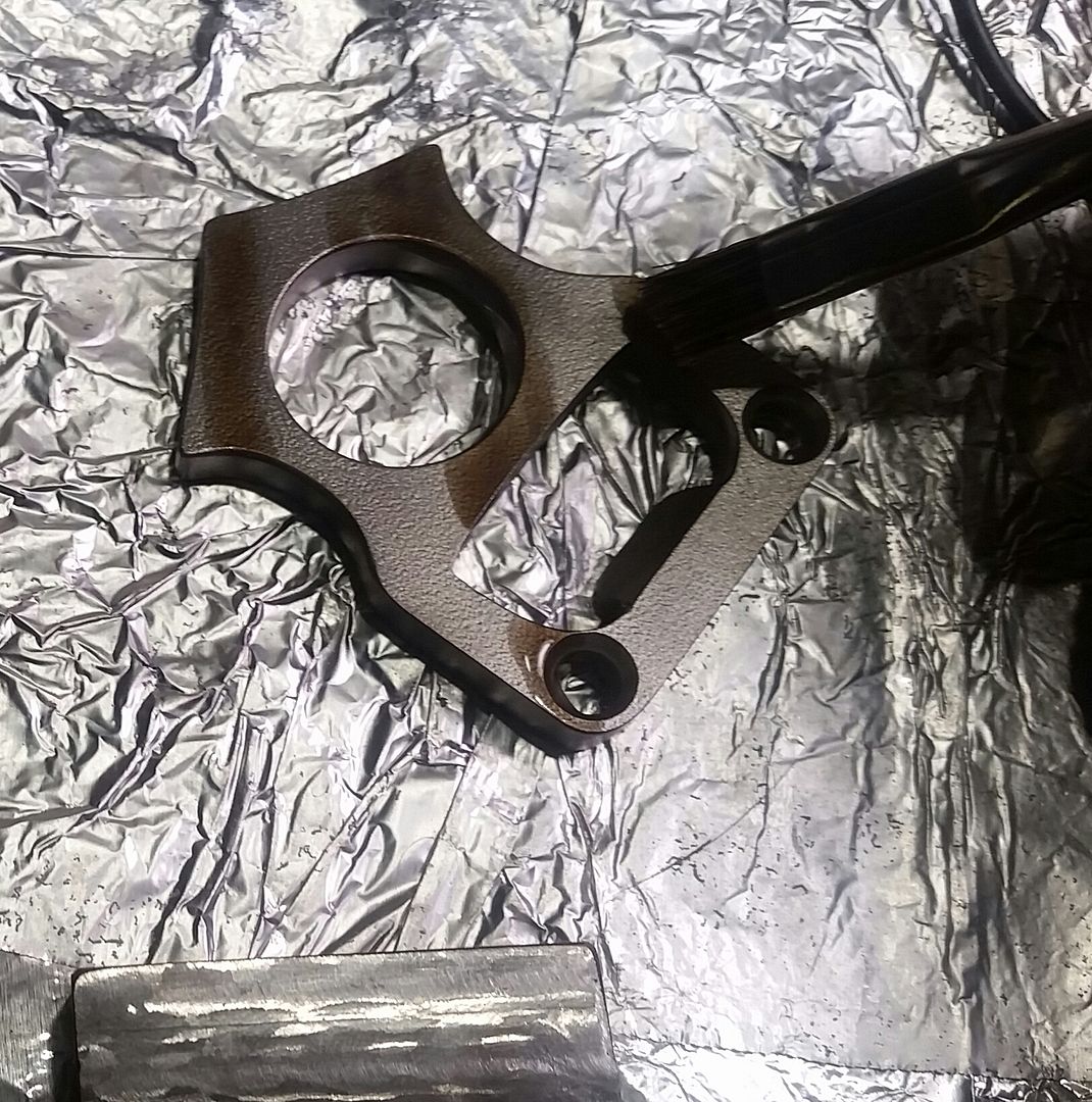

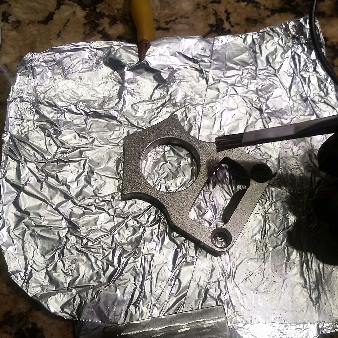

Set your aluminum foil out flat. I've found crinkling it a bit helps make multiple points of contact while allowing excess liquid to run away etc. The positive lead goes to the aluminum foil mat. The negative lead goes to the metal band behind the bristles or the metal stem of your brush. Just make sure there is a clear path to the brush head and fluid.
Dip the brush in liquid and just start painting however you please... I usually start with low voltage and cover the entire piece in shades of the more gold tones. Then go up in voltage from there.
You will get some bubbling and some heat... If not you have a disconnect somewhere. Again, this is why lower amperage is a good idea. As are rubber gloves. Electricity follows the path of least resistance. So you can play around with higher voltage allowing the solution and distance from the brush to create some neat effects. If done in lines like shown, you will see the center of the strokes get a nice blue color and the shades follow the gradient the further they are from the brush.

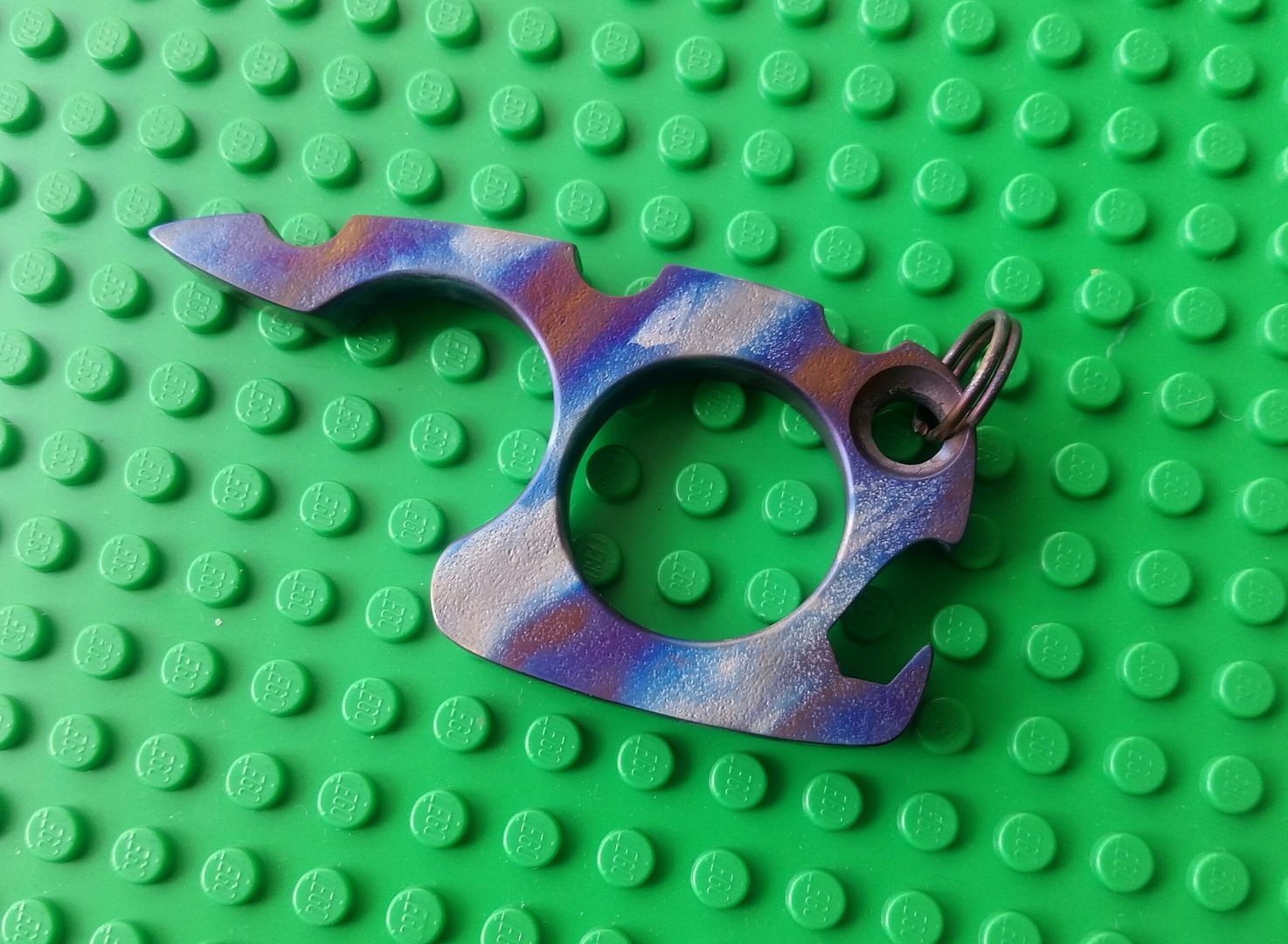

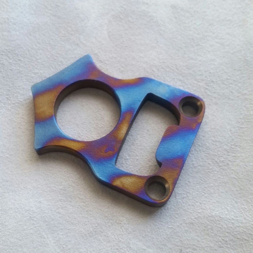

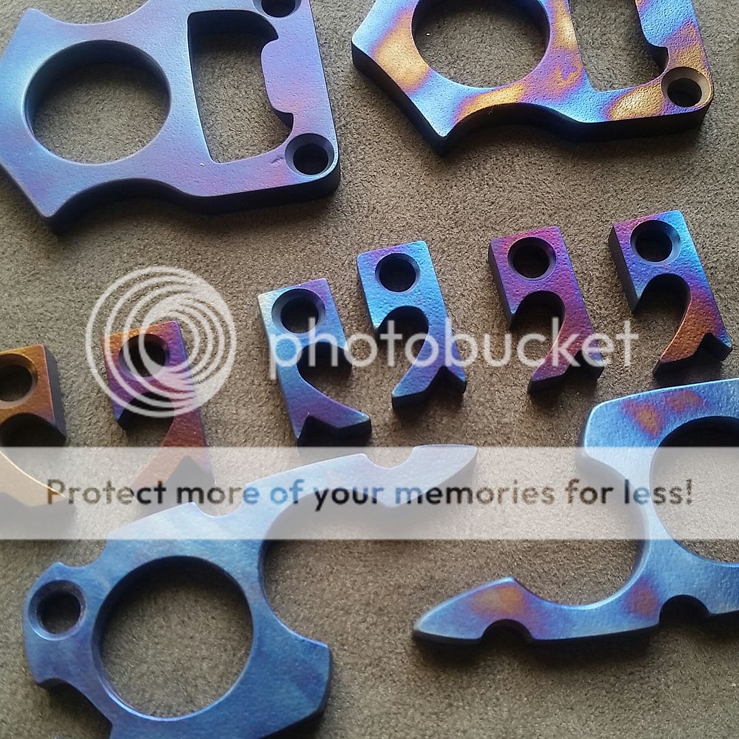

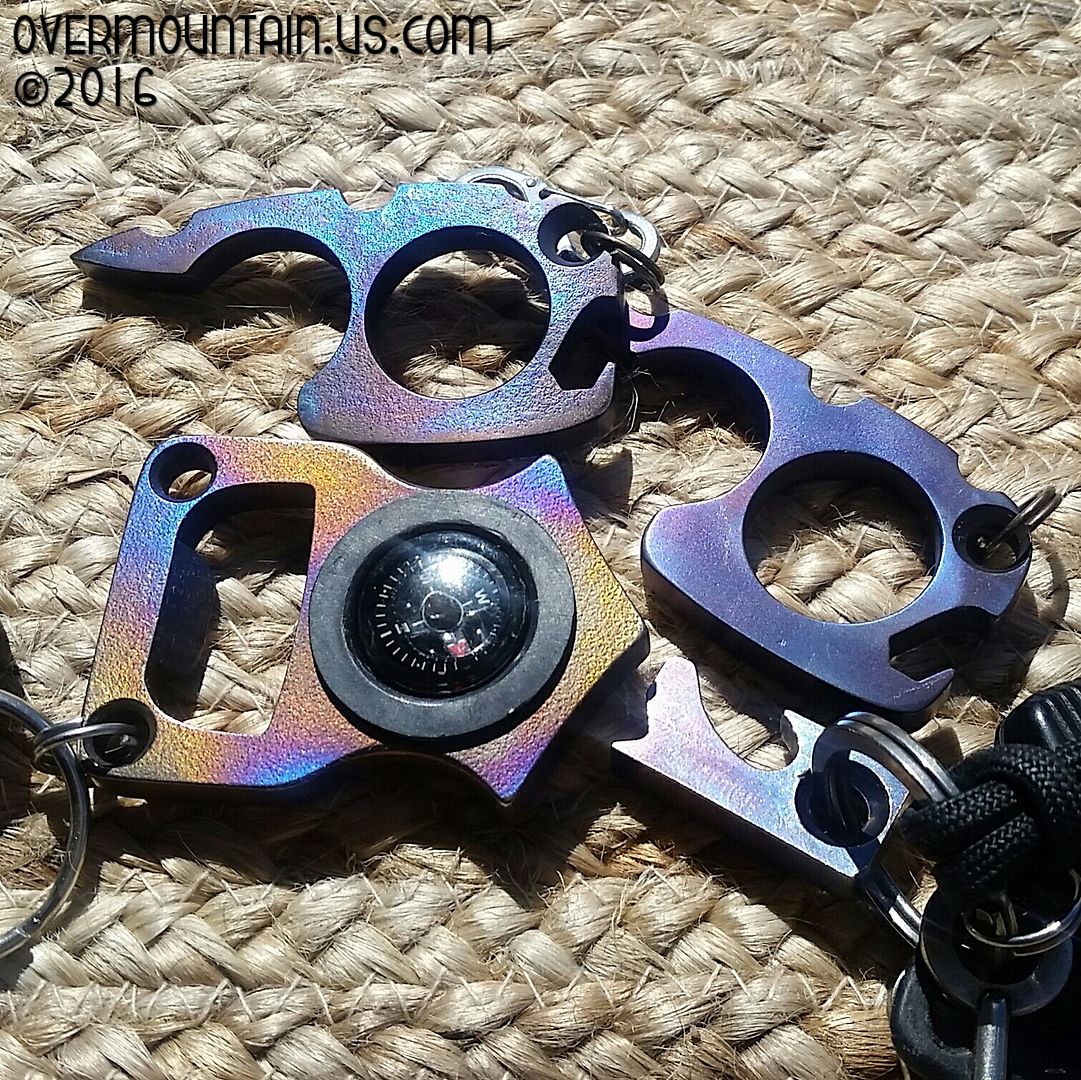

Some examples below...

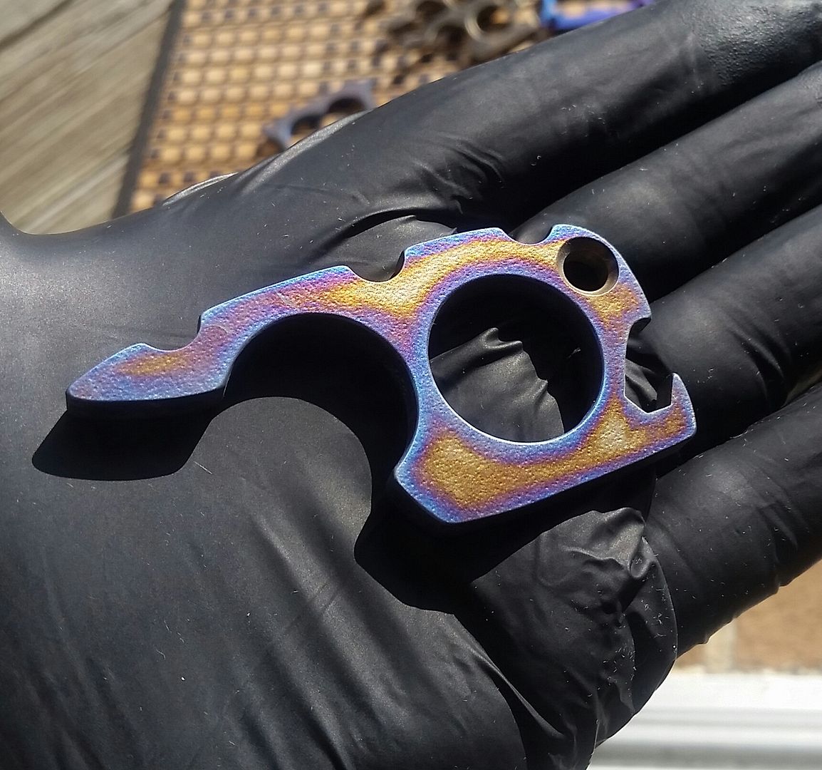

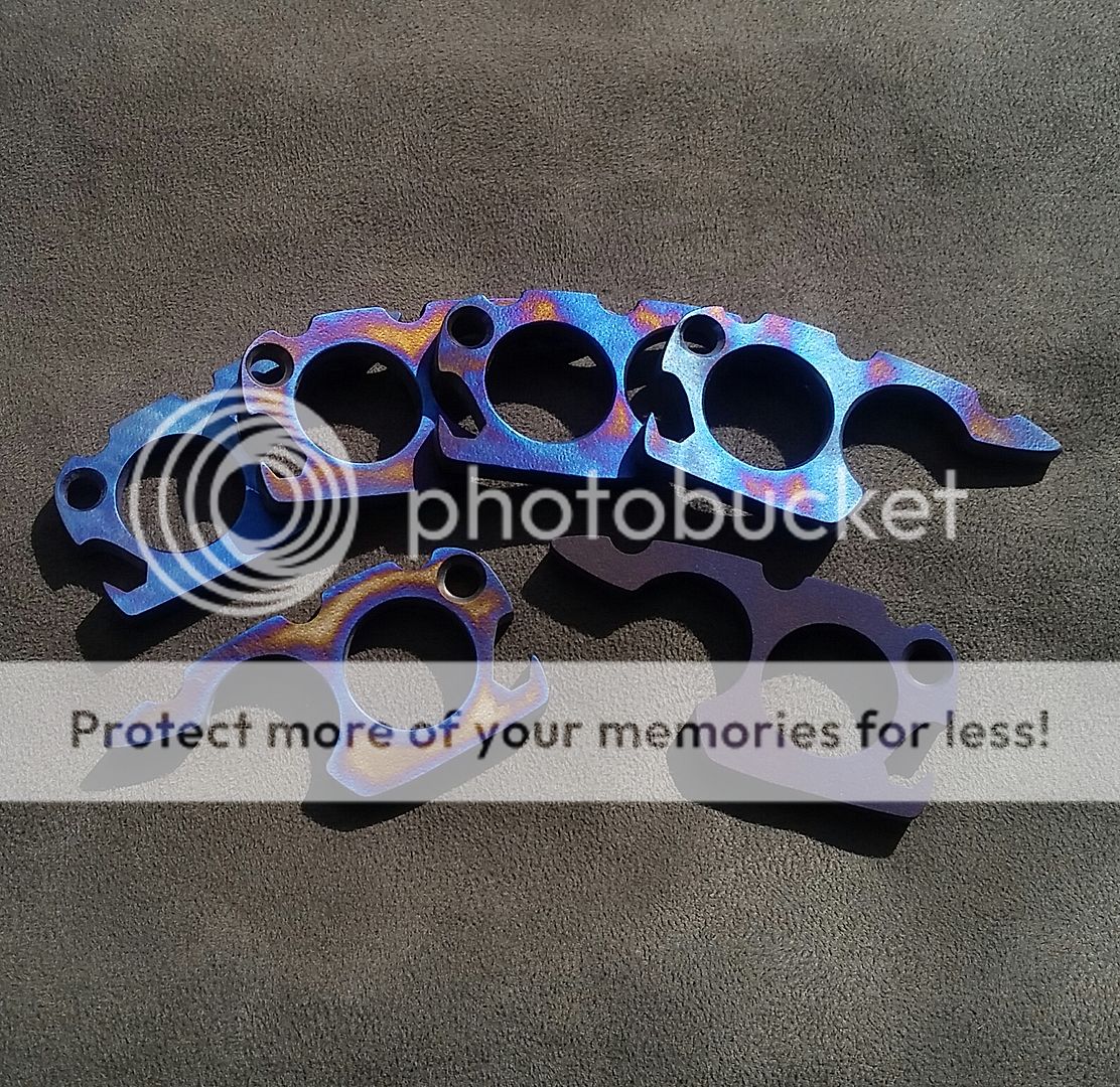

And my recent absolute favorite.... We call it the 'Tron' effect...
Have fun with it. We use heat and electricity with Titanium all the time. Matte finishes can be achieved by using a sandblasted surface. You can mask areas off if you like, etc. Just because you can't afford the $100 per square inch Timascus or Mokuti doesn't mean you have to settle for monotone...
