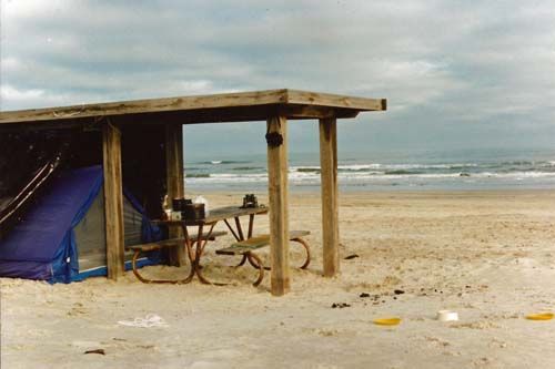

Not wanting to exaggerate the lifespan of my aluminum cookware or its ongoing trial by fire, I pulled an old camp pic from 21 years ago. ;)
You may recognize the Texas Gulf driftwood patina on the pots?
