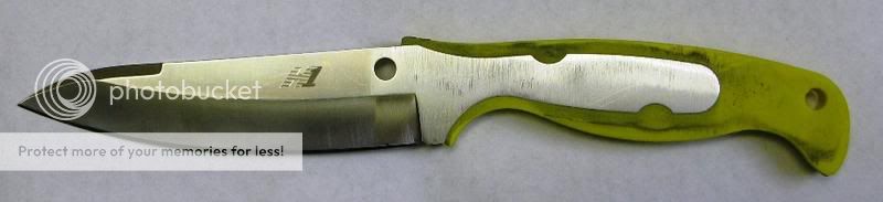

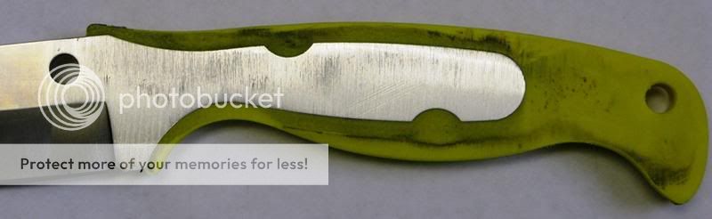

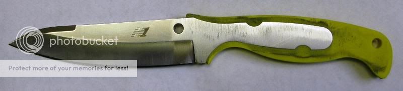

Have you seen these pictures from Spyderco?

So is it not considered a full tang fixed blade?

Hi Elkins,
It's about 3/4ths of the way through the handle, which is injected molded onto the notched tang. We've got a picture coming.
Franco is right about my answer. You won't break it.
If Franco would like to send a Busse, Fehrman, Cold Steel, Chris Reeve and SOG models, I would be happy to break them for you and compare strength graphs. We have the equipment to test them and I wouldn't mind a bit of a wager on the results.
Full tangs have an advantage in that if the scales breaks off, the knife can still be used.
Disadvantages:
The scales are held on with pins, rivets or screws which are weaker than a quality FRN handle injected onto the tang.
The full tang permits moisture to get under the scale which can induce rust (not a problem with H1).
Full tangs add weight, even when tapered or skeletonized.
