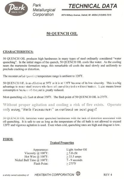

FYI, here's a bit more info on P-50:
note that the working temperature range for Parks 50 is 50-120 F; do not pre-heat P-50 except to bring it up to the low end of that range in cold weather.
John
