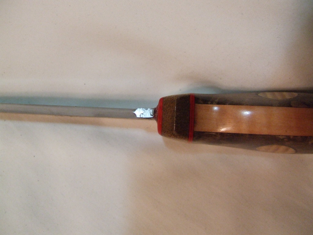

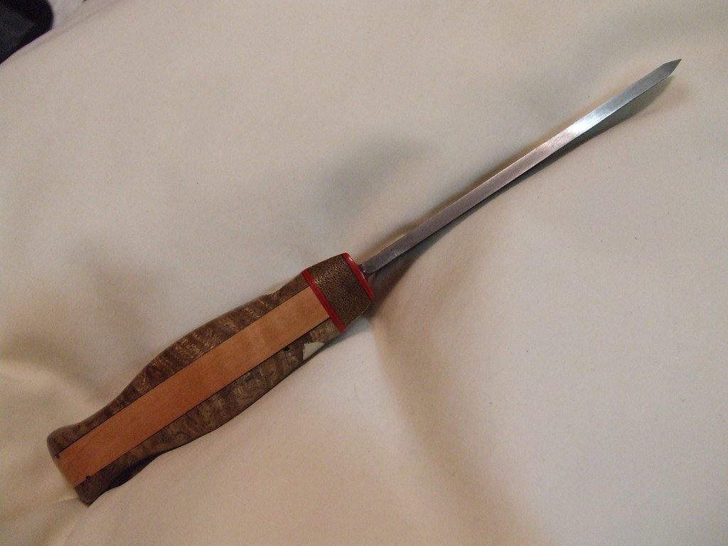

I put a custom handle on this blade. The problem is, I set the tang in there cocked at an angle, so the blade is not straight up-and-down. I think the picture will make clear what I am saying.
I worked so long and hard to shape the handle, I hate to remove it. I believe it would be impossible to remove it without destroying it.
Will this defect alter performance in a serious way? Thanks for any feedback.
If you use it enough, you won't notice the off angle cause you will be used to it.
I wouldn't worry about it too much.

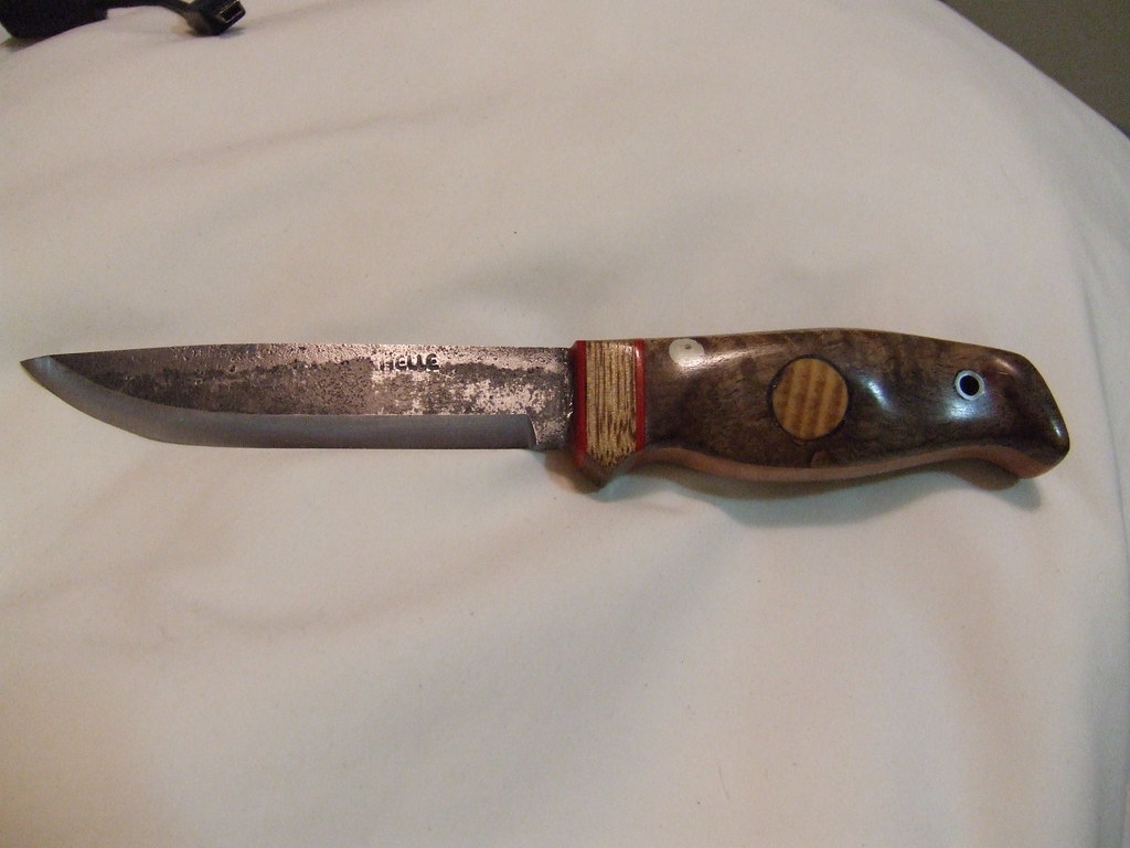

Thanks, Angus. And thanks for the feedback. One thing I like about this knife is I know it is super tough.

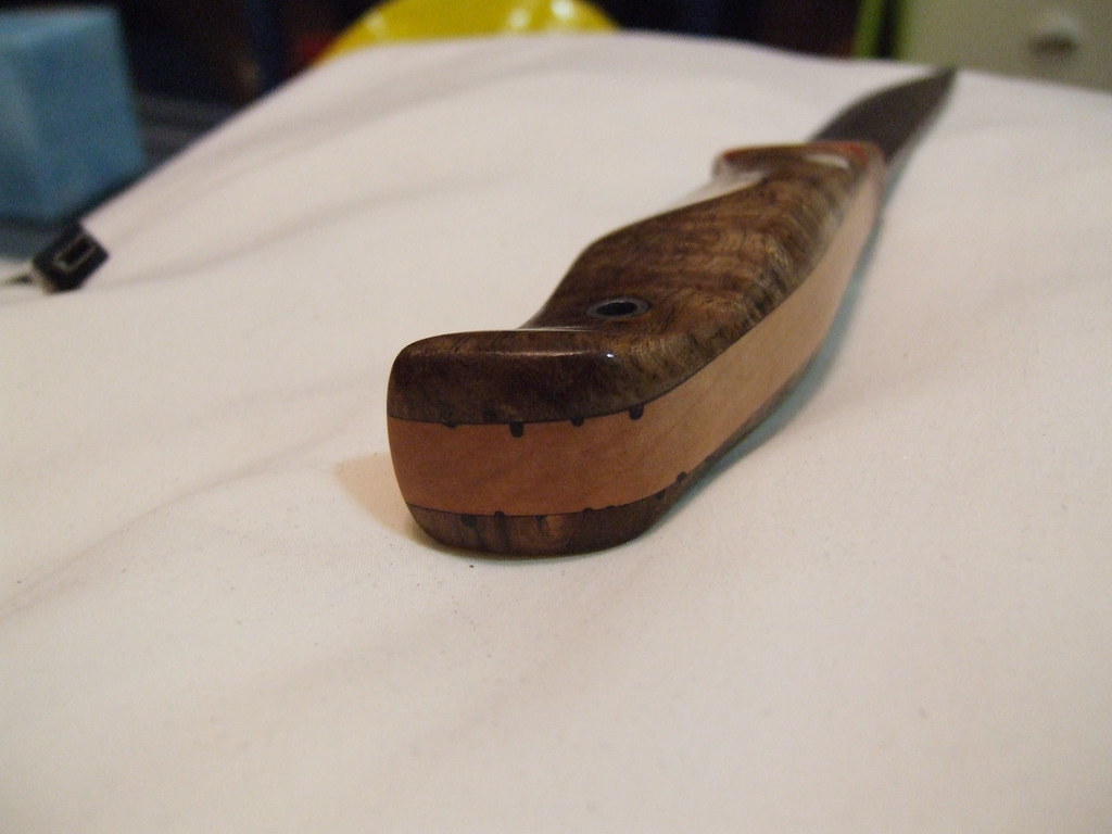

It's a quirky handle. It just kept evolving. The white spot is marine epoxy, and as you can see, I stuck a dowel through it, too. I still haven't decided whether to keep it or sell it.
Divots filled with epoxy:

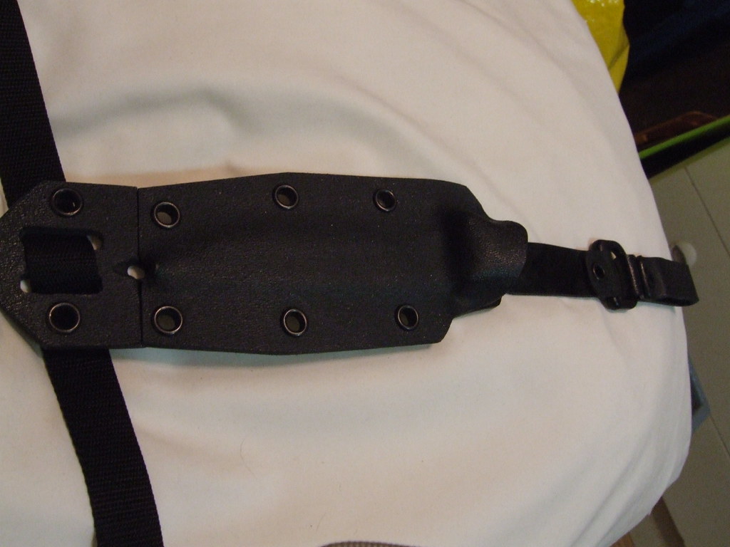

I like how the sheath turned out, even though the leg strap is over the top:
Great work on the handle. I don't think the angle on the blade will make much of a difference. Functionally it is a non issue.
