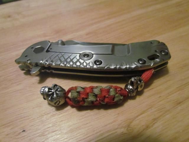

Get a small file set at Home Depot, etc...cost around 8 bucks for a basic set of files...and do it yourself. It is fairly easy. I put my knife in my vise between two pieces of cork to hold it without damaging it. I got the cork at Home Depot too. It is samples from their flooring dept. I grabbed a bunch of different samples, including some carpet samples and find they work great to hold a piece in vise jaws.
Here is a pic of my 566 with jimping I added to the flipper and file work I did on the steel side.
