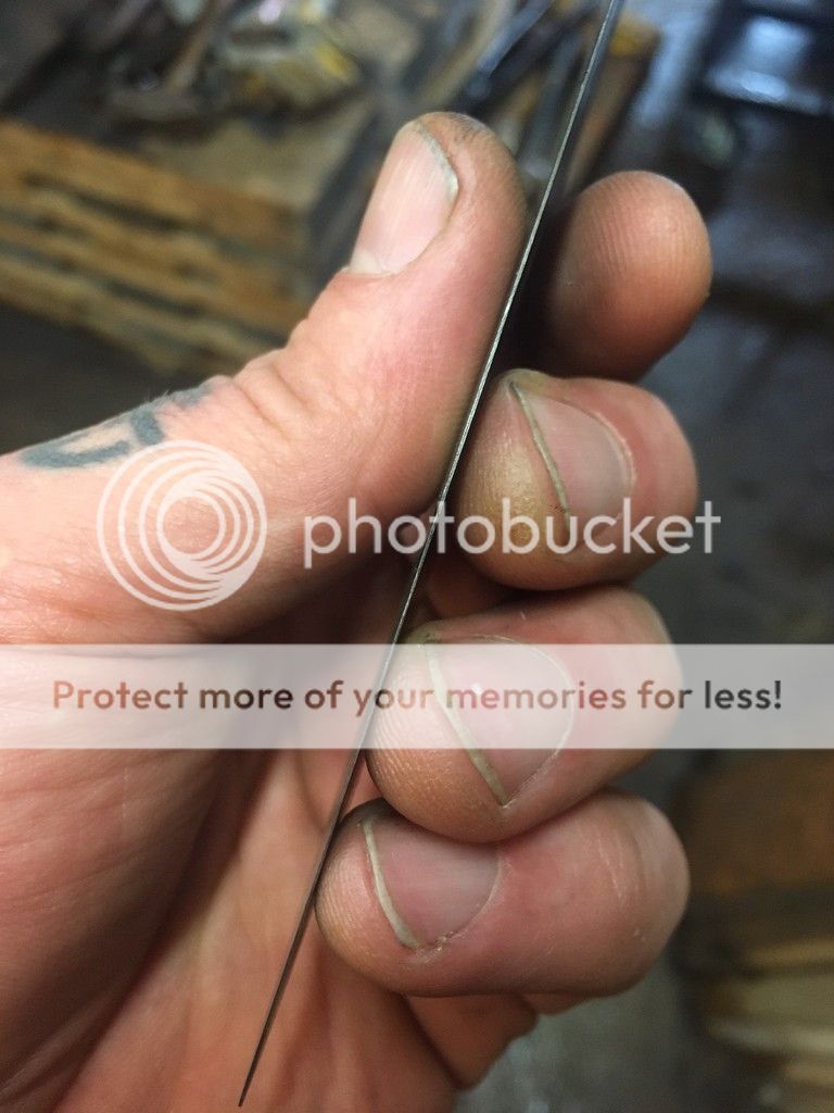

I recently acquired a power hammer, a 25lb "Canadian giant"! So,. the first thing I did was jump in head first and bang out a piece of a huge wrought iron spike I had . When that seemed to work out ok I figured I'd try to sandwich it with a piece of sawmill blade., then that worked out too so I kept going until I eventually had a knife.
Now. My problem. I heat treated the blade as I always do with the sawmill steel when I use it, in an Evenheat at 1500, canola at 130, temper 2 hours at 400 twice. Always worked decent before. After post HT grinding however I noticed the blade will bend, and not spring back. The edge is hard, but I also know I didn't expose the carbon steel for the quench.. I never thought of that until after the fact.
SO. My question.. Do you need to grind past the outer steel clad on a blade like this to allow the core steel to harden? (it sounds so obvious in my head now) Or, if the core IS hardened, is it staying bent because it is too thin, and the soft clad isn't allowing it to spring back?
The core is hard and springy but the wrought iron on the sides is not so if you bend it the thin spring inside is not strong enough to force the wrought iron back straight. This is why San-Mia is tough becaus the cladding is not hard and won't crack but it would spring back ether. Just because something is tough does not mean it's good for knives
A desirable trait for a sword though. A bent blade can be straightened and you can continue fighting. A broken blade makes for a very bad day...
It's a balancing act, if the core is thick enough, it won't bend as easily, but you won't show as much of the cladding with full height grinds. Thicker blades the ratios are easier to maintain, it's why you won't see many san-mai pocket knife or really thin blades, with soft cladding by western makers.
However, many/most Japanese knives are made this way, it's a part of their knifemaking tradition to use thin hard cores and have knives be straightenable by hand. I've always been curious whether this came about from material economy, simply being frustrated with straightening (which has affected all of us at some point or another), simply as an extension of the sword making construction choices, or some other reason. Like much in Japanese culture, I think the authoritative answer is likely lost to traditionalism and history.

Certainly in older times laminated blades arose because steel was far more precious than iron. However, it's not merely tradition that keeps Japanese makers producing laminated blades. The bevel of a laminated blade is far easier to thin on stones than a monosteel knife. This is why many chefs in Japan (and the West) like these kinds of knives, since you can more easily maintain an optimal cutting geometry.

Eh? I'm gonna have to disagree with this. Yes, typical Japanese grind type and edge geometry *does* make it easier to maintain edge geometry, by simply laying the entire bevel on a stone. However, this is much more material to remove than the secondary bevel on a western style grind (and you still have to abrade the hard part, in a much longer cross-section), and as someone who made, and worked with a massive amount of this type of material, I can tell you, that having secondary softer steel, isn't an advantage when grinding or sharpening, it's a burden. Having two dissimilar hardness metals makes cutting inconsistent, the soft material loads the abrasive much worse, "pulls" itself into the abrasive, causing inconsistent cutting speed, and you're still going to have to cut the hard steel, no different than if it's mono.
You could in fact argue, that having half the cutting bevel laying on the stone being hard, and the rest soft, that it's *MORE LIKELY* to cause you to cut more into the soft material, producing a mild convex to that bevel, as opposed to maintaining a flat angle.
It's also highly contentious whether in knife sized tools, there's ANY advantage other than saving material and making straightening easier to use this type of construction. I would argue that from an objective view, mono-steel is a much superior construction methodology, since if you straighten it properly before and during HT, it will maintain better rigidity (less likely to flex in cuts, which is usually a boon, except in the rare specialty tasks where flexibility is required), and should *never* take a set of plastic deformation after this. A fully hard, mono-steel knife in the hardness ranges we typically use, especially in high end kitchen cutlery, will not, if properly HT'd exhibit plastic deformation and take a set, before breaking. i.e; You should *never* need to straighten it.

I guess we're going to have to disagree here. If you look at most Japanese single bevel blades, there actually is supposed to be a slight convex to the bevels. Yanagibas and usubas, for example, are supposed to be sharpened with a slight hamaguriba (convex edge). The softer cladding allows you to more easily sharpen back into thicker sections and raise the shinogi line. In this, I guess our experiences are just different. I find it much more pleasant to thin tall laminated bevels on a stone vs monosteel and haven't noticed loading problems, etc.
It's important to emphasize, I'm talking about thinning, not merely sharpening. I have nothing against monosteel. Many chefs prefer it. But monosteel knives will eventually have to go back to the maker for thinning (and this is often done in Japan). A Japanese sushi chef is more likely to thin his laminated yanagiba as he sharpens; that's simply the sharpening culture over here.
