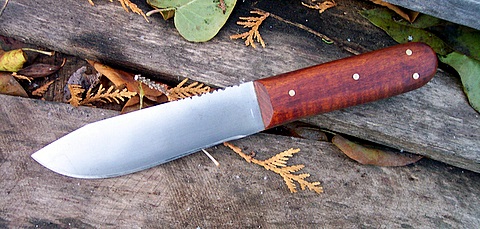

Here's a great version of this design by North River Custom Knives:
This one doesn't have a bolster, and the handle is more of a kephart-style, but it looks good.
And here's another version:
All the best,
- Mike
These are actually close to my Early Hunter model, just a bit longer, and different handle shape.
