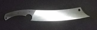

I got this done on the weekend... not my design but I ground and sanded this beast:
Now you can't tell from the pic, but this is a big beast! That's an 18" edge and the blade is over 3"wide. I'm glad I'm not hand sanding this!
Now for scale... it's 0.385" thick!!! I full flat ground down to about 0.030" for stability in HT. About 1lb 5oz ended up being beveled off. I've done many blades this thick and much thicker but rarely FFG on such a wide piece of steel... a lot of work involved, not so much in rough grinding but in taking off the major grinding marks from rough grinding. Finished weight is 4lb 1oz.
Bevel terminations are my pet-peeve and because this one has a specific angle as a design feature I actually sanded out a model in acrylic to practice. It's interesting that to hit the angle you want you have to grind at slightly more/less than that angle, as the bevel termination is usually slightly radiused and the intersection of a cylindrical plane into an inclined plane is geometrically interesting ... hard to explain and more intuitive on small blades. Here they are:
In case you can't tell I'm proud of those... NAILED 'EM
