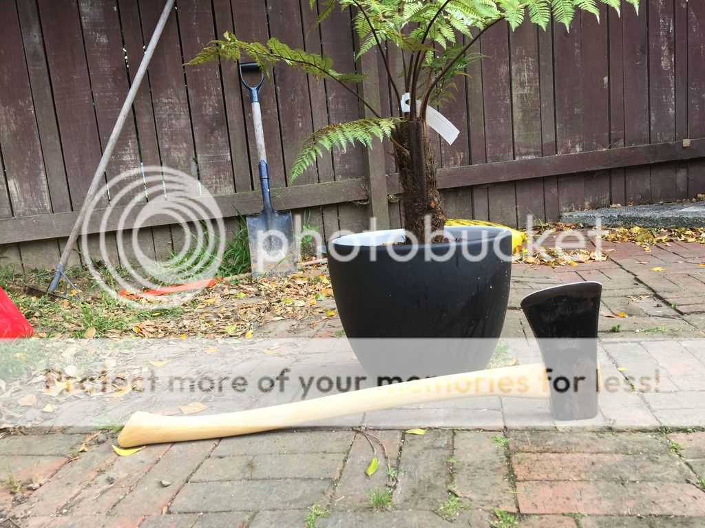

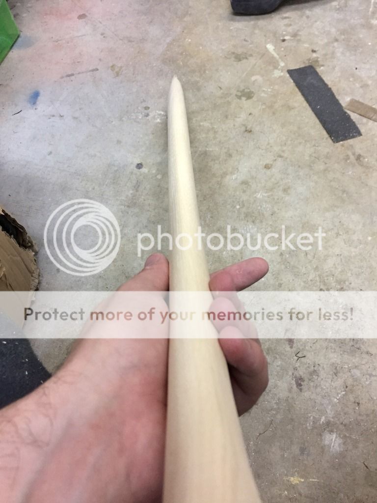

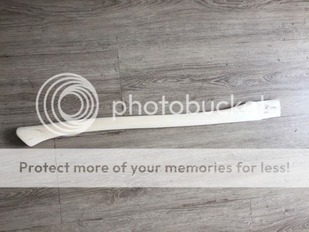

I managed to get some work done on my new plumb rafting / construction axe over the last couple days.

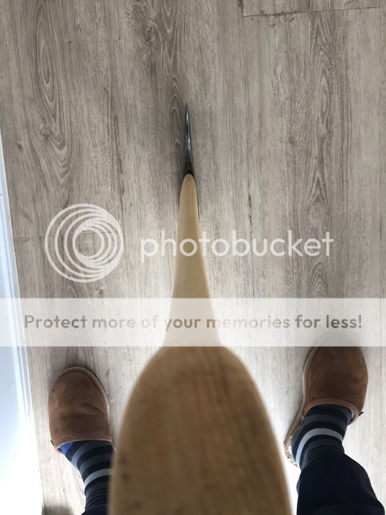

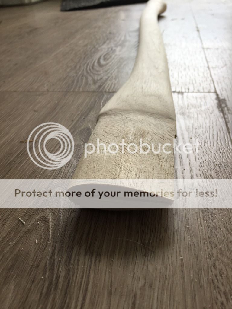

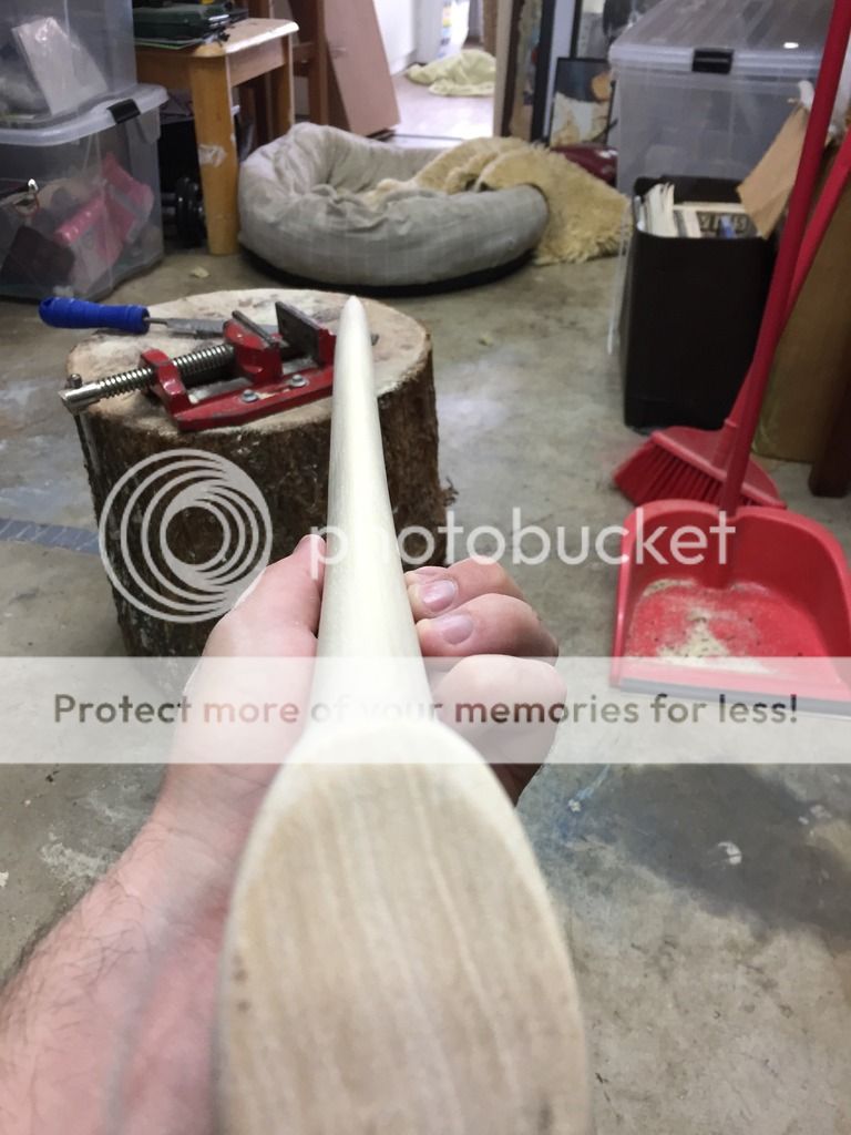

I got a handle (32" only had an option for curved), which at first look I thought was pretty good..had really good grain direction.. was in a rush (lunch time) so didnt look at it too much more...but got home after work and noticed this..uh ohh. I decided I had heaps of wood to work with, and I like working on stuff so I set to work truing it up and thinning it down with my rasp (and making it less curvy)
excuse my messy garage / storage area..haft is getting better
pretty good now..

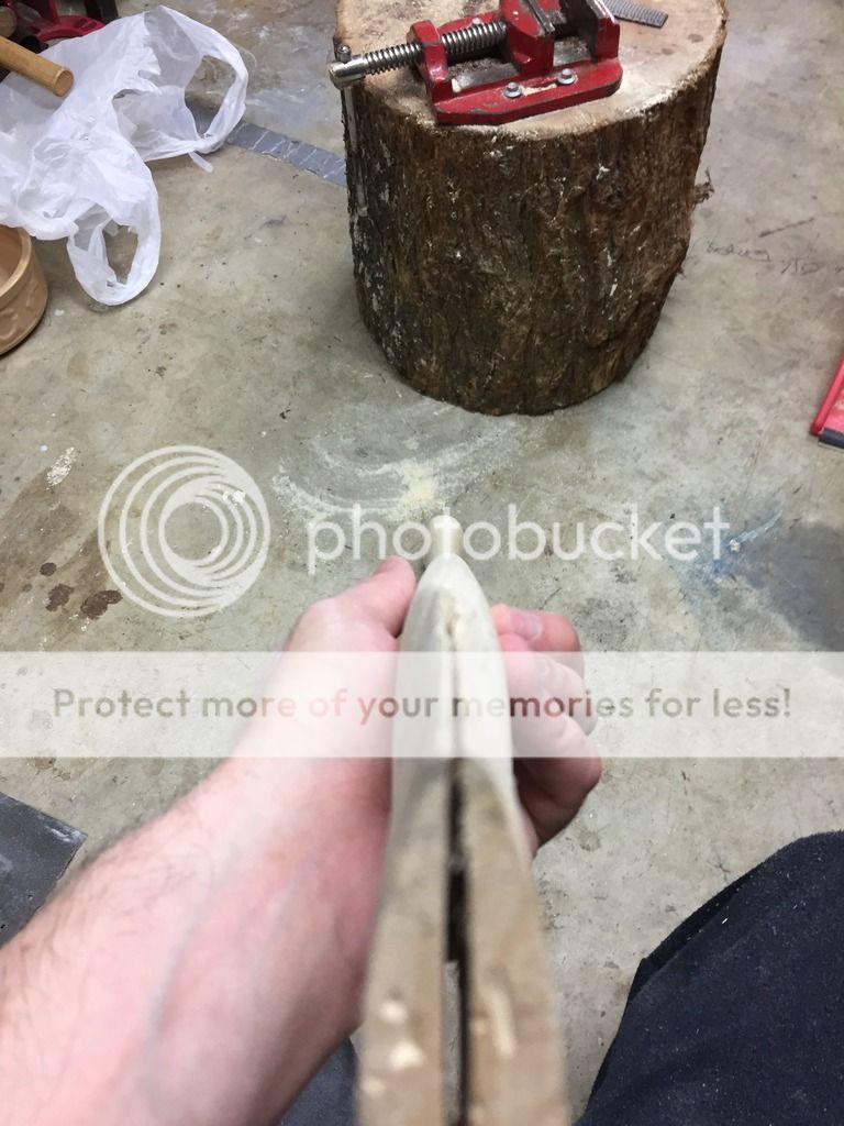

mostly finished handle

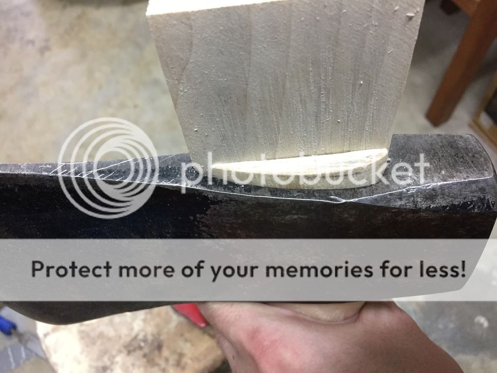

prepped and ready for hangin'

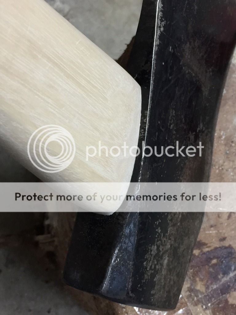

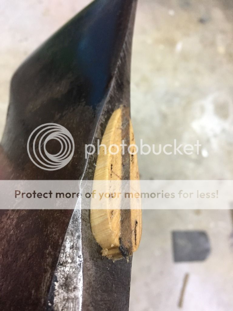

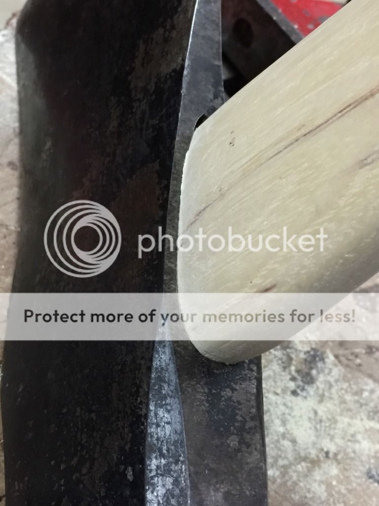

perfect fit, no gaps, very very tight without the wedge (took about 30-40 rubber mallet hits to remove head from handle after each test fit)
wedging..again very good fit before wedging

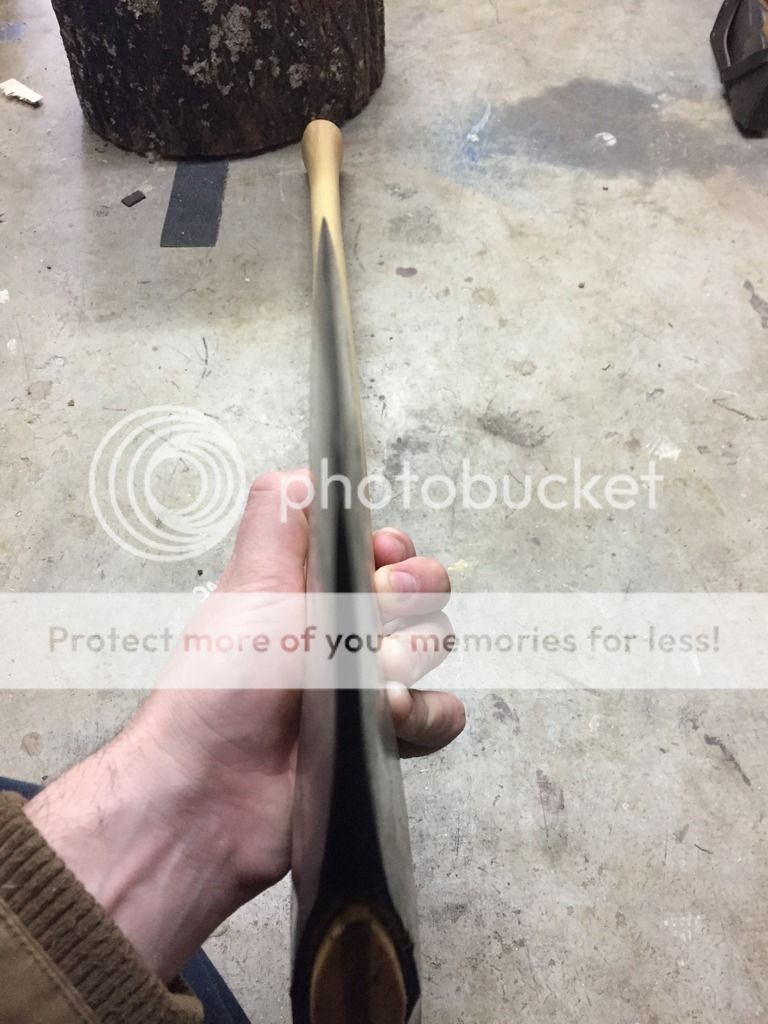

shes straight as :thumbup:

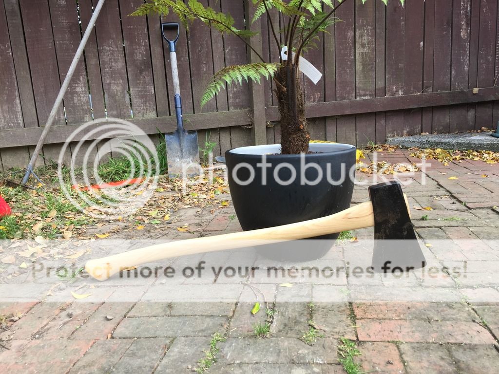

how she hangs
Very happy with how this one came out, im confident the head aint coming loose :)
I decided to leave the head as-is (at least for now till I change my mind) and not remove any of the old paint or anything..
Just needs a sharpen now :D
You did a nice job of this. The handle looks to be a compromise between conventional full length and a miner's stubby version. Put'er to work and let's hear back about what happens.

I did constantly have the thought in the back of my mind that most guys re-handle these with a straight handle to make better use of the hammering end/poll, so I did what I could with what I had to work with. (could not buy any straight axe handles at the store)
Handle does feel very nice though, its quite thin, tapers smoothly up to the eye, no humps or lumps :)
Is that the 5 lb plumb national? Nice job shaping the handle!
It's more like the "Constructors" axe shown in this Plumb catalog from the mid-1960s (bottom right), which was available in 4 and 5 pound head weights. The "National" pattern is shown here (left column) with only a 3-1/2 pound weight.
And I agree, a great job with the handle.

Part of the reason they make such great splitters is how thick they are. The eye walls are almost 1/4" thick and the poll is almost 1-1/2" thick. Add the 5 pound mass and it's just an awesome combination for splitting.
