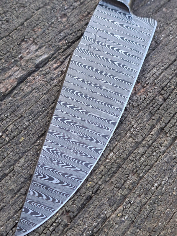

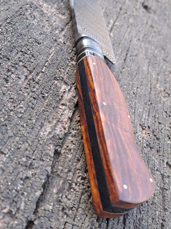

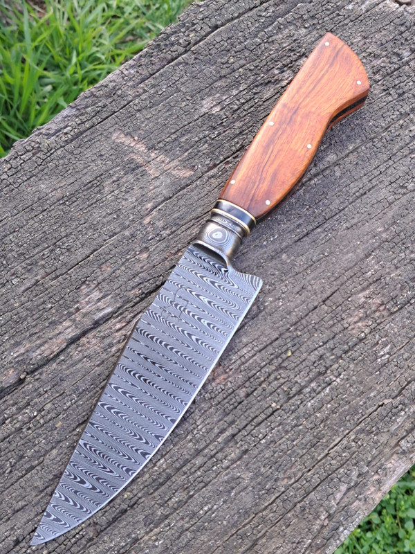

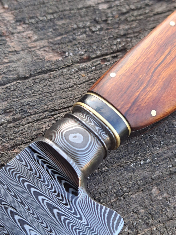

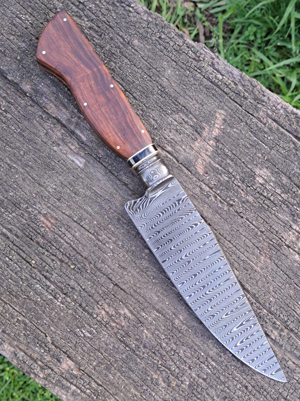

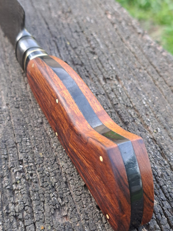

Hello friends, I show you a knife that I have just finished, it is a hunter reworked in ladder pattern damascus steel, the button is integral and has a file job, it has a false chassis made of 5160 steel, polished and blued, as well Like the collar, the spacers are made of brass, as are the rivets.
the wood is ironwood treated with tung oil I need to do the pod! hope you like

Beautiful work! This looks like a modified criollo. Is this a traditional design or your own adaptation?
