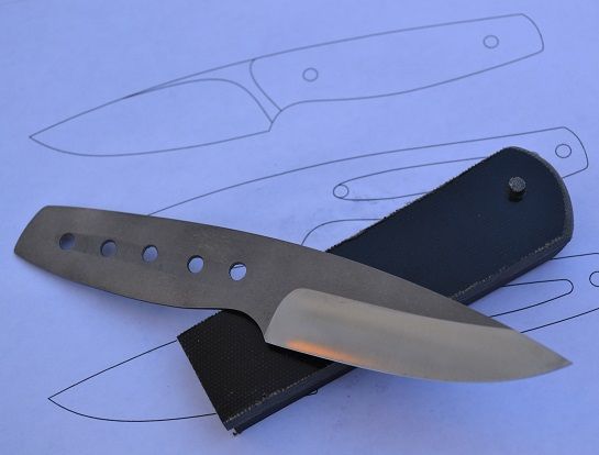

I'm working on making the most useful, ergonomic and good looking all around knife out there... the DFK Hunter!
Other goals are a full sized, yet compact handle and a blade that is big enough do do most anything. Light weight, strong with great edge holding.
I'm still not there on my steel choice but am leaning to CPM154 in .155" thick. 60-61 RC
These are a good ways off... here is a prototype in thin AEBL that I profiled without a template... the handle profile feels as good as any knife I have held.

3.8" Handle
3" Blade
I wear an XL glove and my hand has a full four finger grip. The handle design took me a while and I feel it maximizes grip length vs most other handle styles.

Look good, I like the design. Although, I feel .155" is a touch too thick unless you're going to distal taper like mad and taper the tang. I personally feel that a 3" hunter should be no more than about .130 and even .100 is quite nice. Very few people I know actually split the pelvis with their hunters, most use a second tool, myself included. Edge retention is paramount, being able to cleanly get through a whole animal from a tiny coastal black tail to a large bull moose is a huge benefit. Anything from 1095 or O1 through S30V or 14C28N should work well, I think. I bet A2 would be great.
Tip looks like it is centered nicely, handle looks comfy (similar design to the Stinger looks like), maybe consider a thong hole - I know some people like them.

I'm listening to input from everyone and really appreciate if you guys that are interested throw in your opinion. Steel thickness is one thing I'd especially like feedback on. My edges are generally on the thin side so these will be geared to the slicey/edge holding side of things.

If you're looking for more of a slicer, why not a higher grind? What you have in your cad mockup behind the template seems to be a quite high grind.
I don't really know a whole lot about the function or history of that design. This is a learning experience for me.
Daniel, your standard edge geometry will do just fine. But, if you took your primary grind to a full zero edge, then put on your edge bevels that thing would be incredible! It would give even the toughest to sharpen steels a small enough bevel that they will sharpen up reasonably quick.
Stock thickness, if you're going to do a partial grind, thinner is better. I too, like the FFG you have on the cad drawing. Personally, I wouldn't want removable wrap handle, when dressing an animal in the field I'm not going to deal with that just to clean my knife. I want to be able to just take a bottle of water and some alcohol based wipes to clean it up. The less maintenance th better. Afterall, that very same knife is going to be making my lunch shortly after cleaning an animal.
My current hunter is unstabilized walnut with danish oil finish, it cleans up easily, looks better with use, and maintains grip when covered in blood and offal slime.
Well sealed handles, design that promotes grip retention when slippery, ability to index in hand without looking, and a tip location that feels natural are, imho, the key design features.
Some of the best hunter pattrns out there to check out, Loveless, Fisk sendero, Buck, DHIII, etc...

Good eye on the grind! That one is made from .070" stock so that is about as high as I wanted to take the hollow grind on it... it will be a real razor. :D
A Hunter is somewhat of a general use design. It should be good for preparing game, in the camp or around the house, easy to carry but somewhat substantial, slicey, ready to use with great ergonomics and no hot spots.

Tall grind like the one drawn and thinner high hardness steel.
I was looking at steel today and seriously consider .130" AEBL steel. It holds an outstanding edge at high hardness without chipping and is easy to maintain. I'm going to test some in the next few days.
Double Black Micarta, maybe a thong hole... either black micarta or flared tube fasteners. I'll offer a skeletonized handle model too.

I really like that design. I think that knife in 0.125" O1 steel, with Desert Ironwood handle, in FFG would be the perfect hunter. I would caution against D2, because in my opinion it is too brittle to be an all around hunting knife. Just my opinion :)
