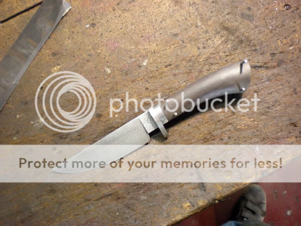

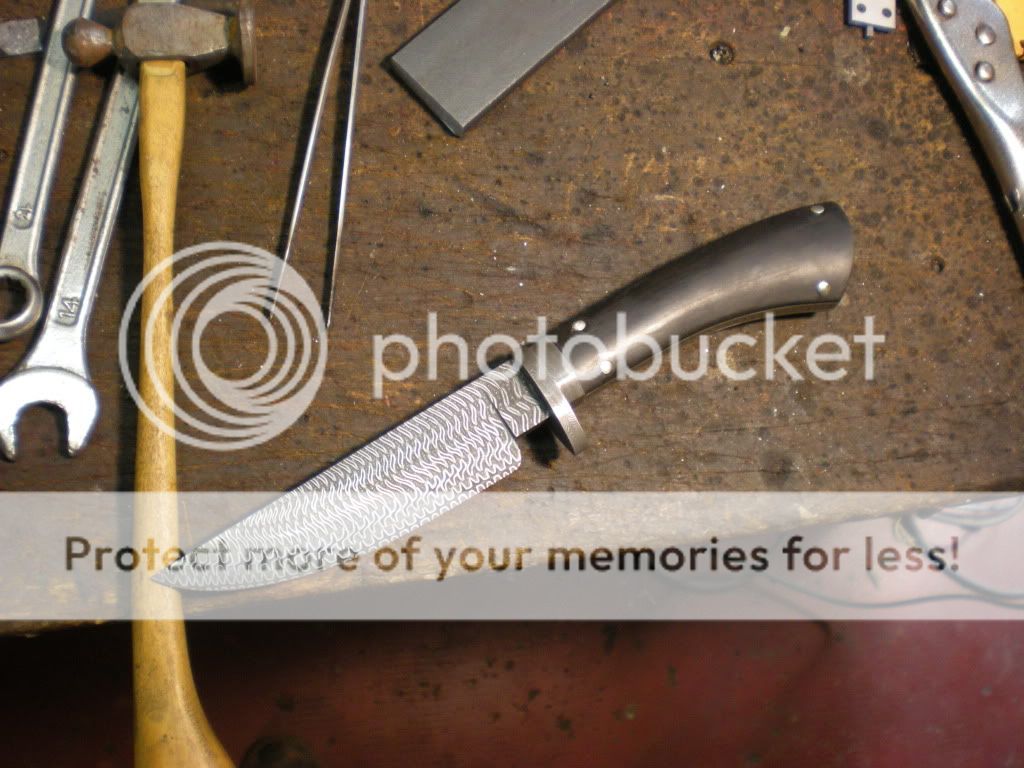

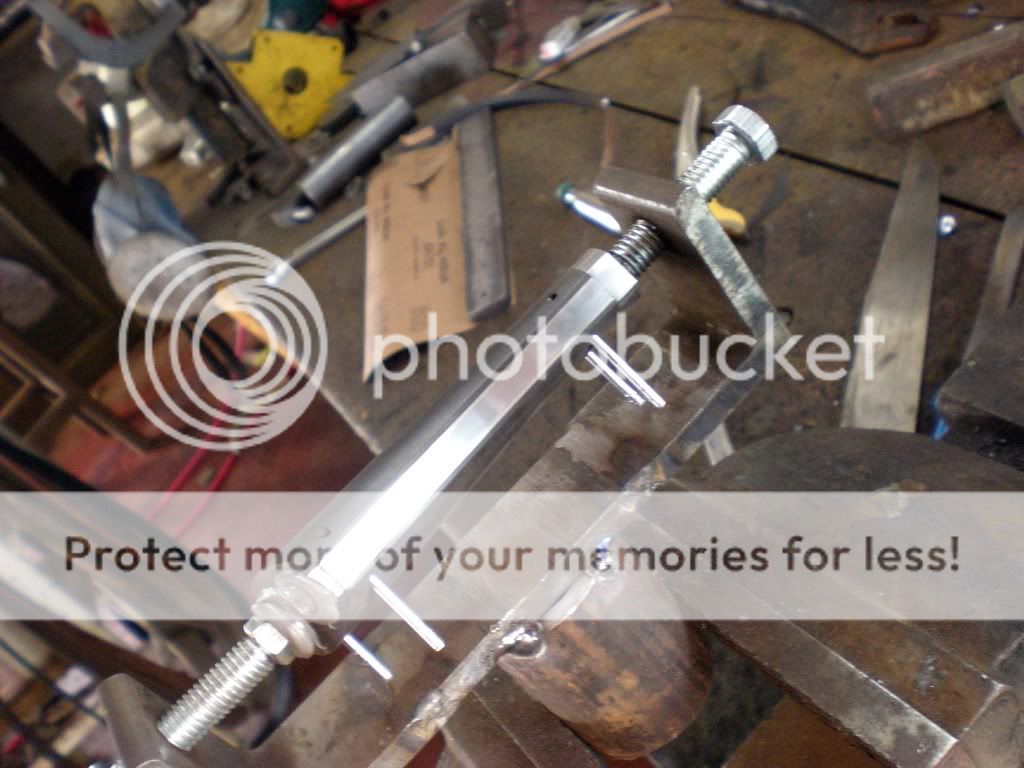

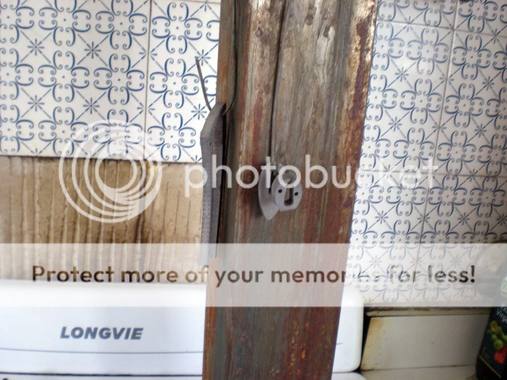

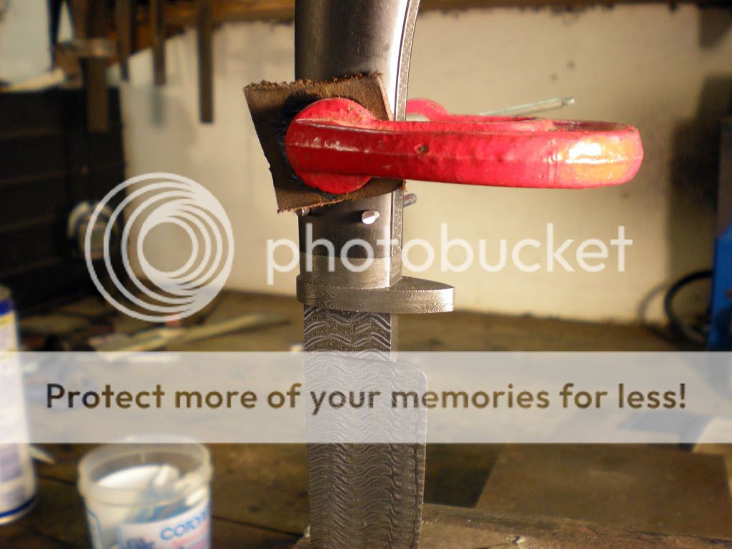

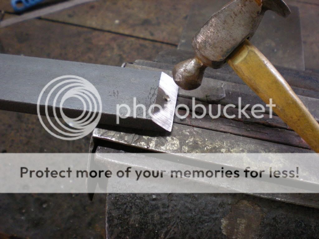

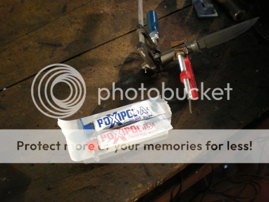

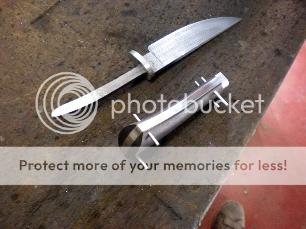

Hi, just finished this one.
It's a 5 twisted bars damascus of 5160 and 15n20, frame handle, with german silver liners and pins.

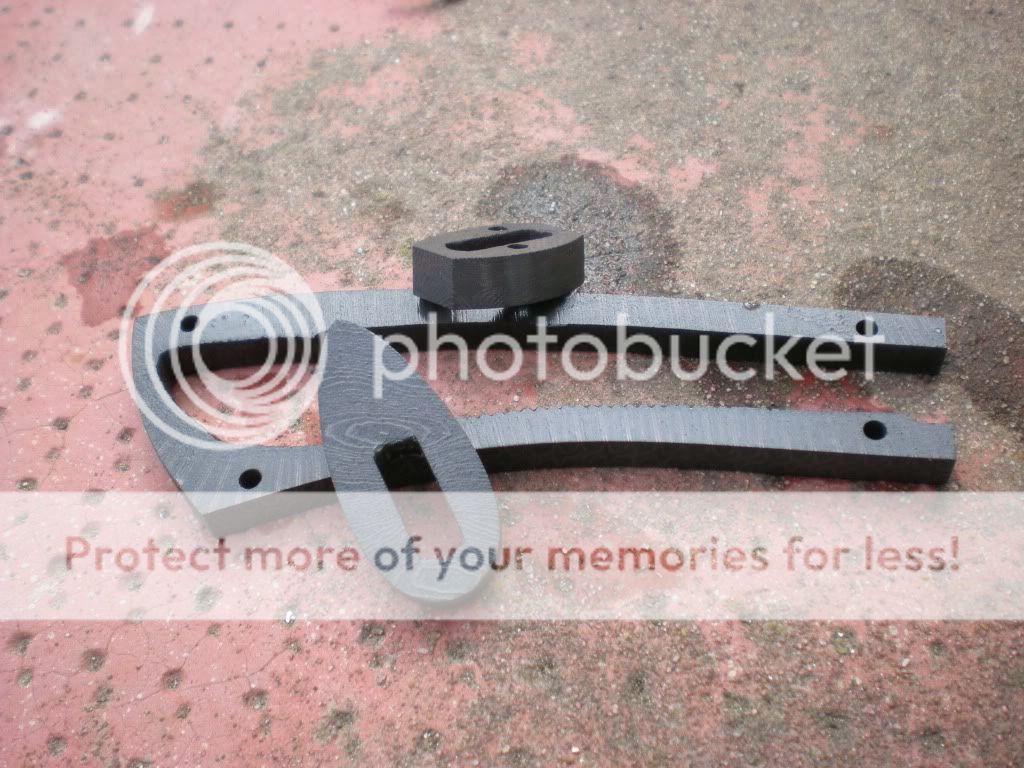

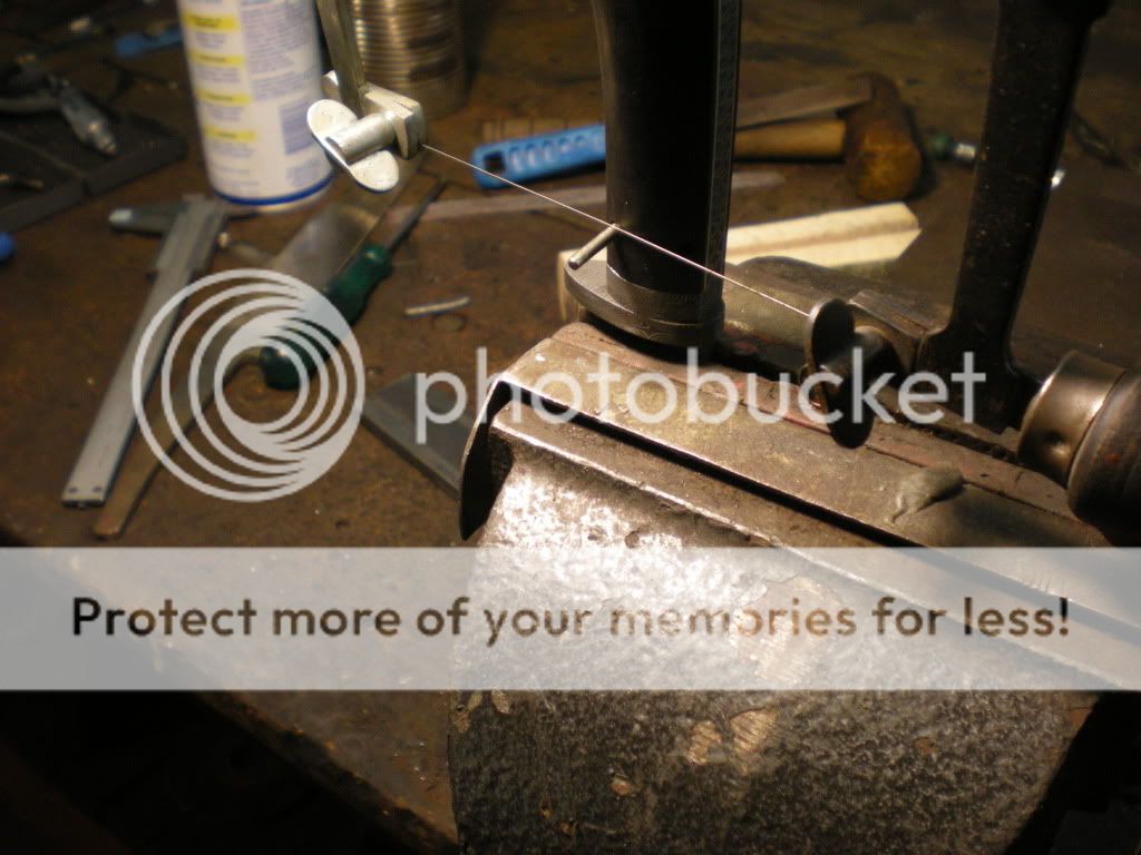

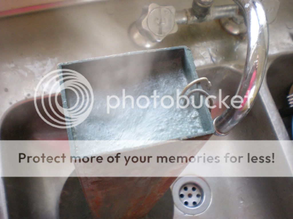

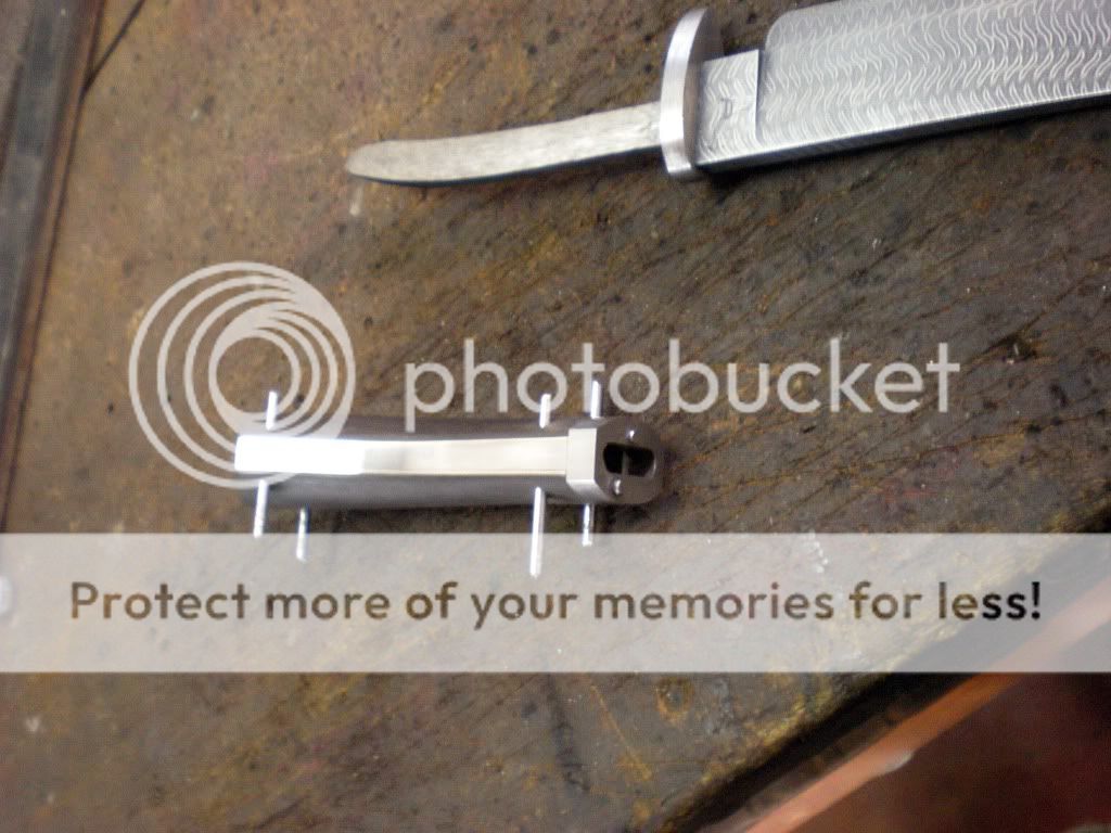

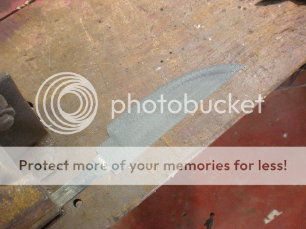

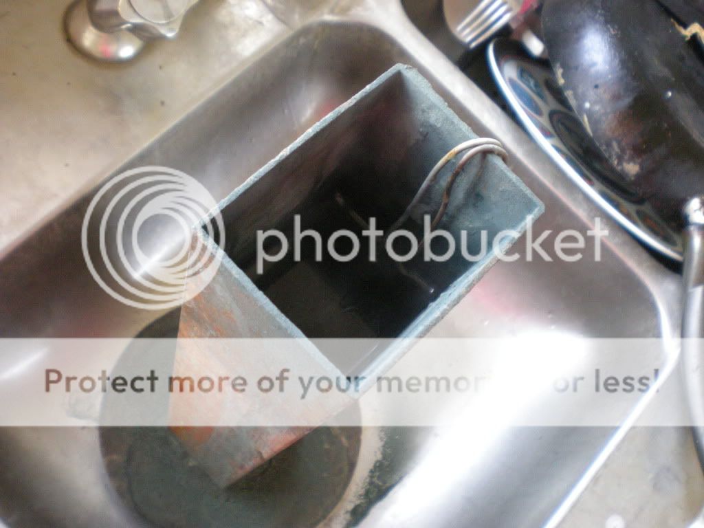

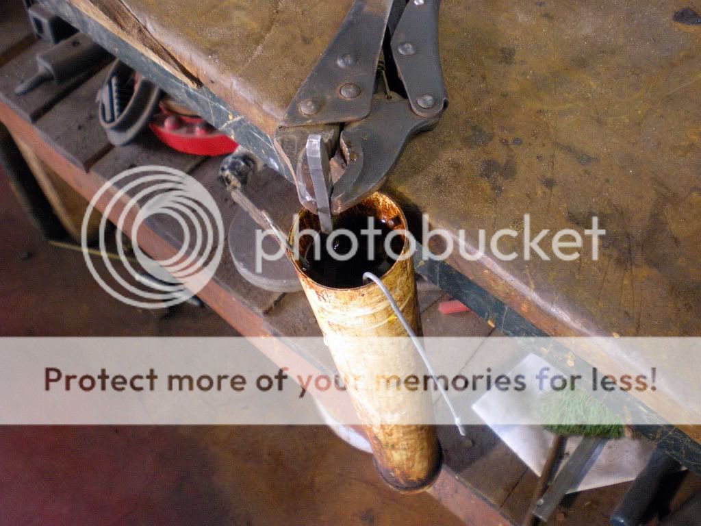

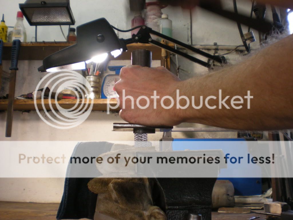

I also have some pictures of the finals days of working in this one, like a micro WIP:
Here I'm missing a picture where the manganese phosphate layer is hand rubbed with a 2000 grip sandpaper, leaving the "hills" shiny white and the "valleys" dark.
Very, very nice all around, Damascus and workmanship.
Thanks for the Mini-WIP, also.
John
Damascus pattern looks great and I think it really complements the blade shape. Nice work.
it is VERY hard to pein pins at an angle like that. Well done! Beautiful knife.
Manuel, one experience doing it myself was enough to convince me never to do it again!
Didn't turn out nearly as nice as yours I must say
stunning work! the merovingian pattern is one of my favorites1 you should be proud Manuel!!
Jeff
I think it is fair to say that there are a lot of world class knives coming out of South America now.
Congratulations on the knife and the damascus.
I love it. Especially the twist running along the frame. I've never seen anything like it.
really beautiful work. I love seeing the old patterns showing up in modern blades and the frame handle touch is exquisite.
