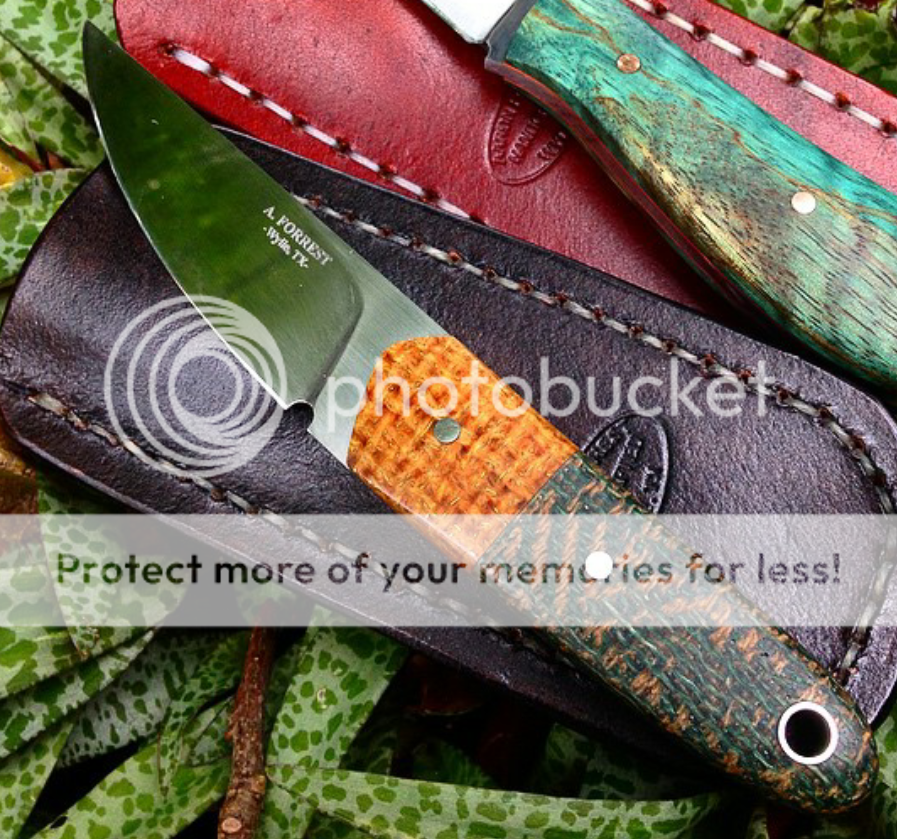

Here is better representation of the true color of tangerine:
